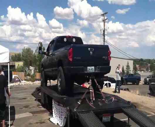

How about in lieu of engine pics (who wants to look at a stock engine anyway?) I post a dyno vid?
Pretty much stock, other than a billet trans, Hamilton valvetrain and one hell of an EFILive tune, 503/1086
It WILL be in the 1k+ club this spring/summer

very nice
looks like you need more air though for that 500hp tune...pretty smokey.
I need to do pushrods and valve springs so I can tighten my secondaries wastegate. I have it loose for now to keep boost ~65psi. If I go much higher I'll float the valves.

Yep, I'm still impressed with how well this truck has run as stock as it is, no doubt more air I'd be at least in the 550 range I think.
The thing I found interesting though is the third run, you see it and it's down 60hp and 150ft-lb from the previous run. Why? Because the FAN came on! I hadn't really thought of it before and how much power it robbed, but there's your proof. Electric fans will be finding their way on there.
Yeah Carl's always tinkering, I've seriously thought about running a supercharger. That blue MegaCab in the background in the vid got Carl's supercharger kit after this dyno event, pretty sure there are vids on CF of it burning the 38's. Pretty impressive I think.
