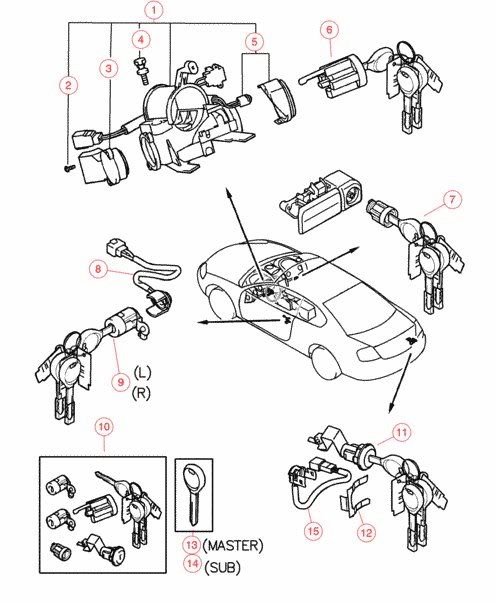

See # 8 in the pic below. It is the door lock switch. When you turn the door lock cylinder, the switch tells the alarm to deactivate..When they broke in, it could have killed the switch... Just an idea....

Check your fuses if they ripped the radio they may have damaged wires and shorted some ...
See if the switch is even still attached I have seen them fall off ...
Also they might have damaged the door switch in the door frame,some thieves pull them so the dome light stay off so they are not seen
