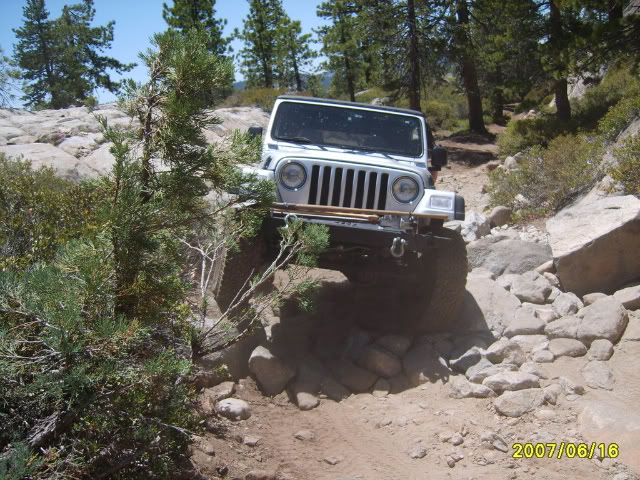

hahaha, you know what, I had an 05 wrangler, (if i can find a picture i post it here in a sec), but a common solution for the jeepin' world is this...
I had a friend who had a rubicon model, and hwen he lifted his jeep, i took his rubicon wheels, and ran them until i sold the jeep. I actually put on a 3" lift, and did some very technical wheelin as well as snow slush play.
I ran a 295/70/16, and never rubbed, that is unless i was disconnected up front, and was on the verge of teetering.
however, i believe, for that size lift (with would just be coil spacers and shocks), 12.50's are going to be a little too wide. Harder on the front end, 11.50 worked great for me, as well as many other wheelers in the jeep community.
The lift I had: http://www.full-traction.com/detail....ID=382&NOTES=9.. .this kit runs about $500 w/o shocks at four wheel parts... thats without haggling.
lets see if i can find a pic of my old rig...

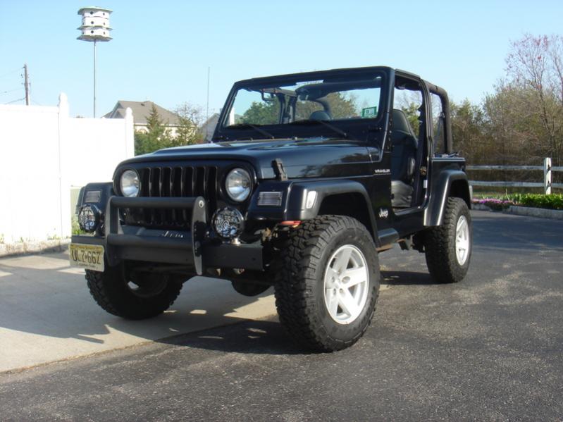

I found a jeep with the rubicon wheels, 2" Budget Boost, and 265/70/16 goodyear MTR's...
Attached Thumbnails Jeep TJ wheels/lift-bbjeeep.jpg
