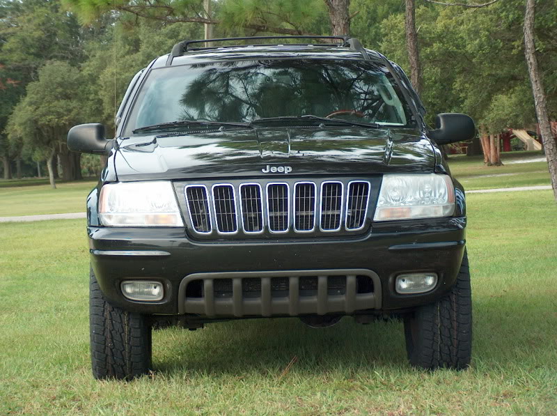

Well I gotta admit my "play toy" is my truck, but I've put a modest 2" BB on the Grand Cherokee so I don't have to make all of my trips to the farm with the truck, 360 miles each way gets old in a lifted pickup.
Not to mention the GC is my camping vehicle of choice.
But I agree with you, Cherokees were sweet and fun to lift. Having had 2 Wranglers, I found that to use them as a daily driver gets old pretty quick. Just too loud and bumpy and a real PIA to carry anything. Maybe the 4 doors are better suited as a DD.
I'm actually debating pulling the coil spacers and installing a 4" suspension lift. My 265/65/17 Terra Grapplers are a bit tight and I'm going to put my old winch from the truck on the front. Afraid the weight of the winch might pull it down a tad in the front and cause some rubbing issues...
