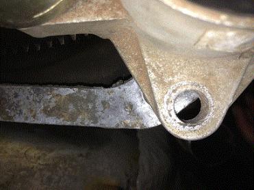

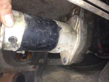

so this is whats up, dodge motor, jeep trans, jeep starter.
if you are under the vehicle, looking at the starter from the front, the starter needs to rotate clockwise like a 1/4 inch so that the bolt holes line up. I can get it on the stud, but thats it...
I was asking about beating the oil pan because at this moment in time thats the only way i can see the starter going on this motor.
Chad

OK, I see what you're talking about. I presume that all this is because you're using the jeep transmission and therefore you need to use the jeep starter. How did the jeep 318 handle this same problem? Was the pan a different shape than the dodge 318? These answers might give you some solution, but if modifying the pan becomes the only approach, I would take the pan off first to make sure you aren't going to hammer on the oil pump. If the oil pump isn't in the way, you should be good to make the change you need to give yourself room for the starter. If you decide to modify the pan while it's off the engine, screw it onto a piece of plywood so that you don't end up distorting it in the process. If you can weld, you might find it easier to cut a piece out and make yourself a concave piece that will give you the room you need and weld that into place - again, I'd attach the pan to something to make sure it doesn't warp during welding.
