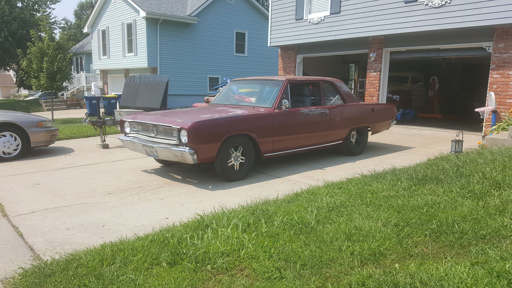

how it should actually sit but my driveway slants down a bit. sits lower on flatter ground. new grill new led headlights with halos and turbos behind the grill. hope to fire it up before my bday july 30th. then make the ice cream cruise race with it for some small tire heads up racing.
