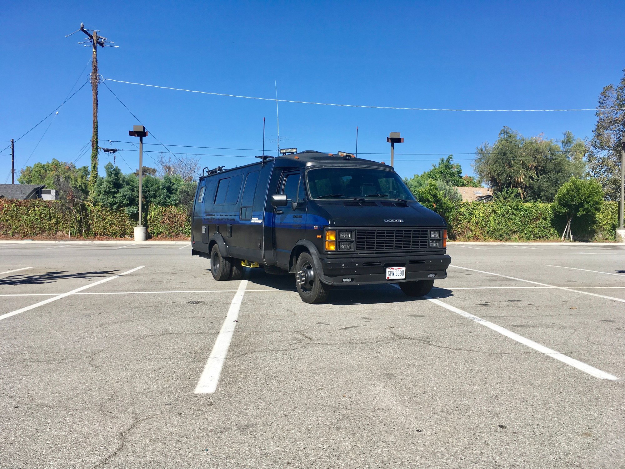

Just though I would add my ride to this forum....here goes
1979 dodge trans van built by champion
MB400 motorhome chassis 14500 GVW frame and suspension

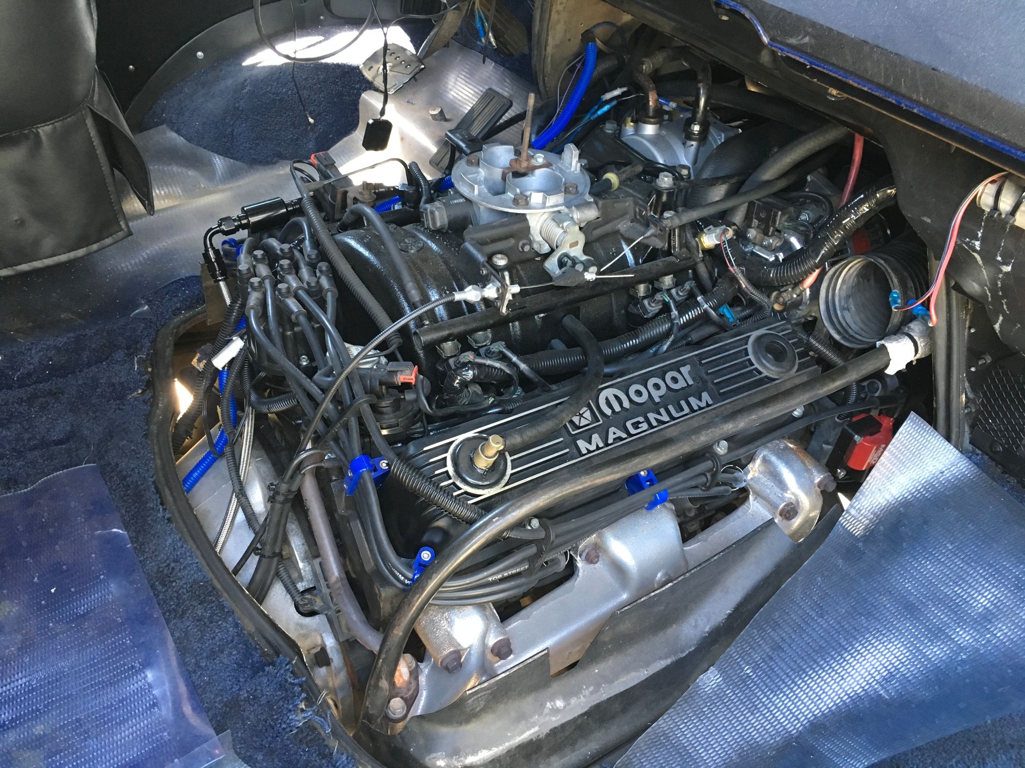

swapped LA motor and 727 trans for. 1995 360 magnum and 46RH transmission
ran a carb for the last 4 years and just installed factory fuel injection
Added and ADCO front sway bar, ( never had one installed from factory)
added rear HELWIG sway bar
5000 lbs overload air bags in back
on-board air system
49 gallon factory fuel tank
LINEX bedliner sprayed on roof to seal from elements
4 optima yellow top battery’s with custom battery management system
external 4 camera system
custom kitchen with bath and shower, grey water tank and sewage tank
full custom front seats with heat and massage
custom floor shifter
1995 dodge van AC system fitted in engine compartment and behind dash
custom overhead console
more pics on my Facebook page. Just look up “TERMINAL DEFIANCE “.

too much customizing to extend the dog house to get it to fit so I settled with a magnum swap...way easier and more reliable

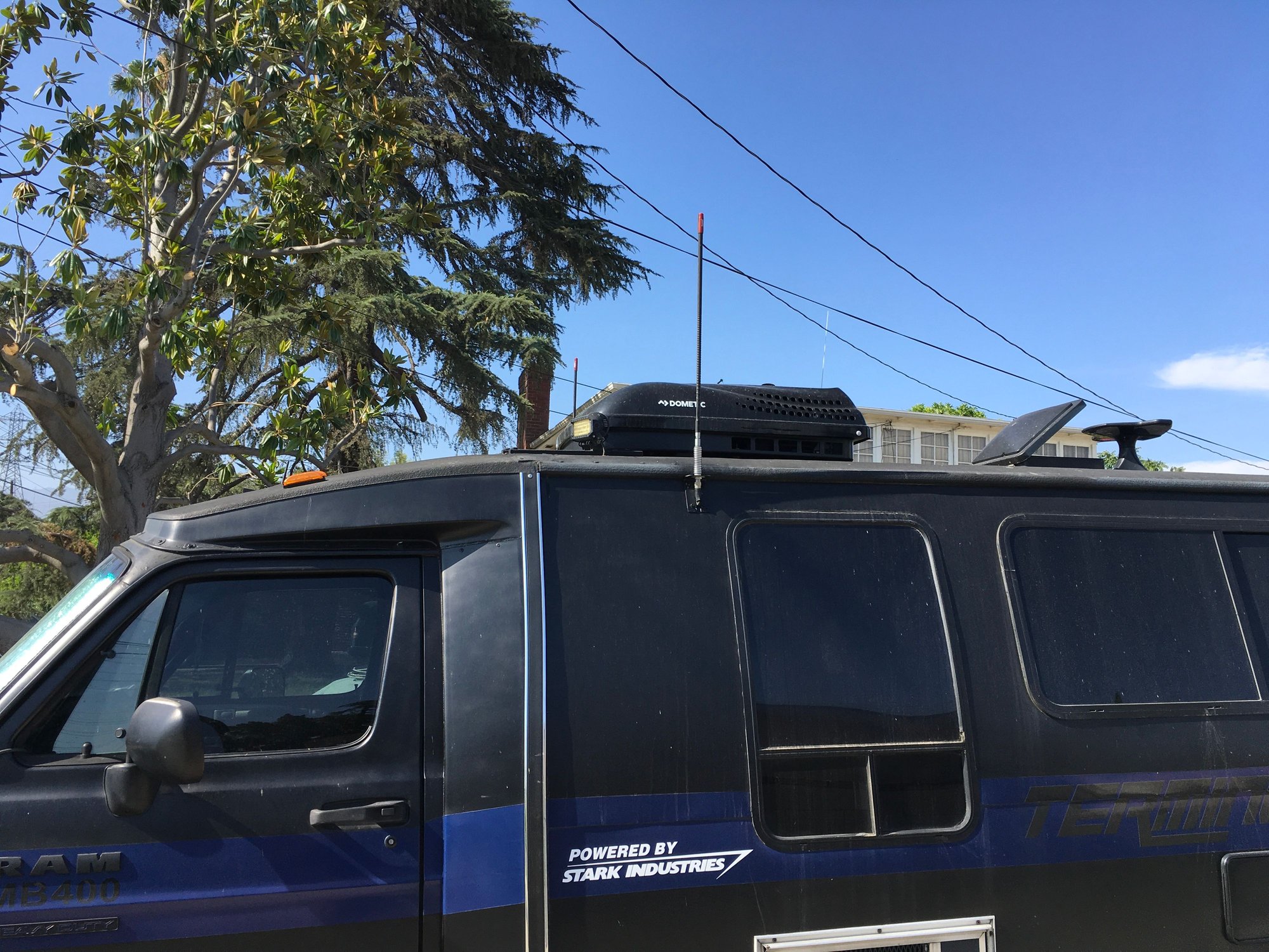

Also check out more pics in the gallery section. Also a recent addition is in the first pic, the roof now has a dometic low profile AC unit

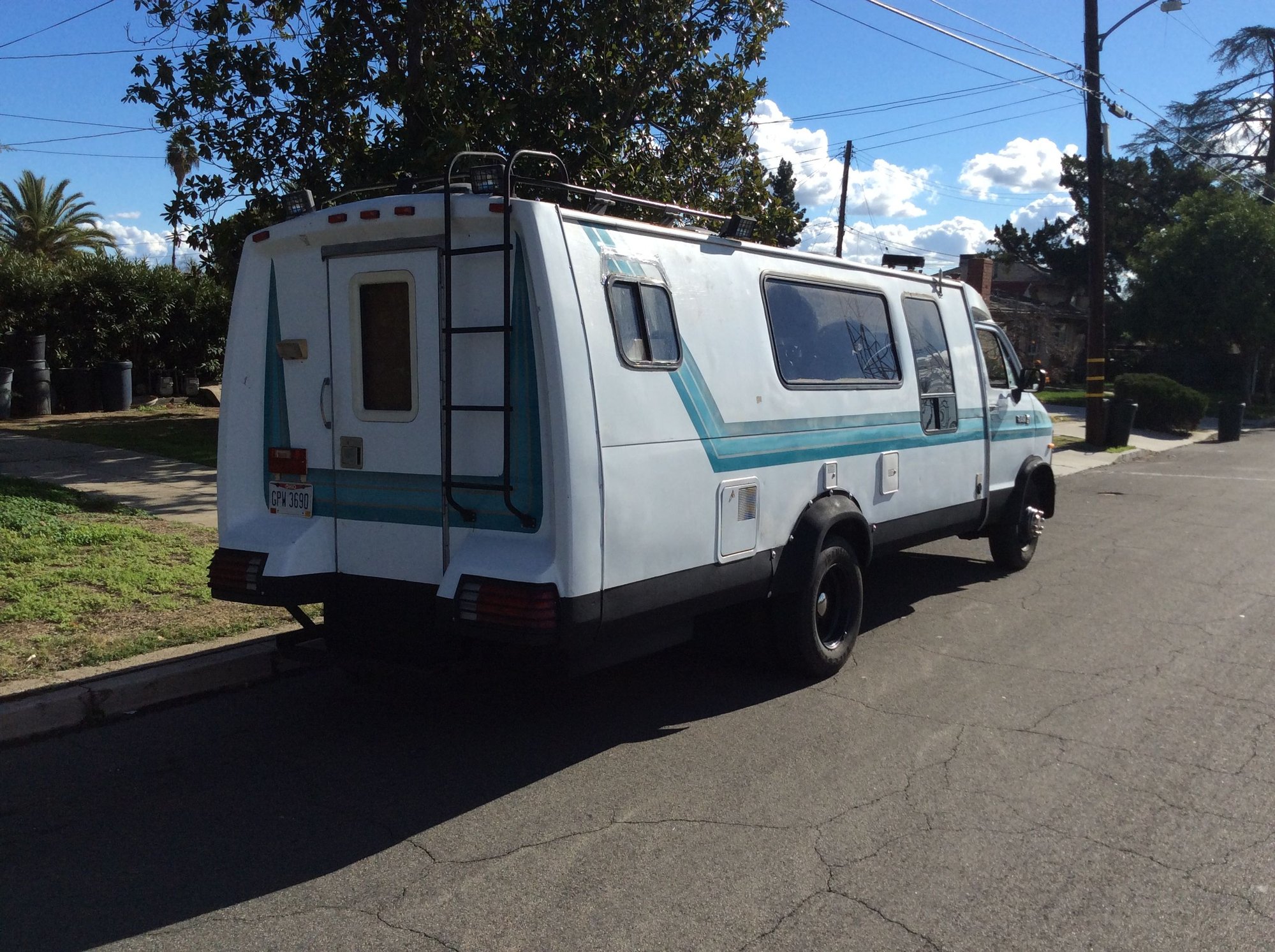

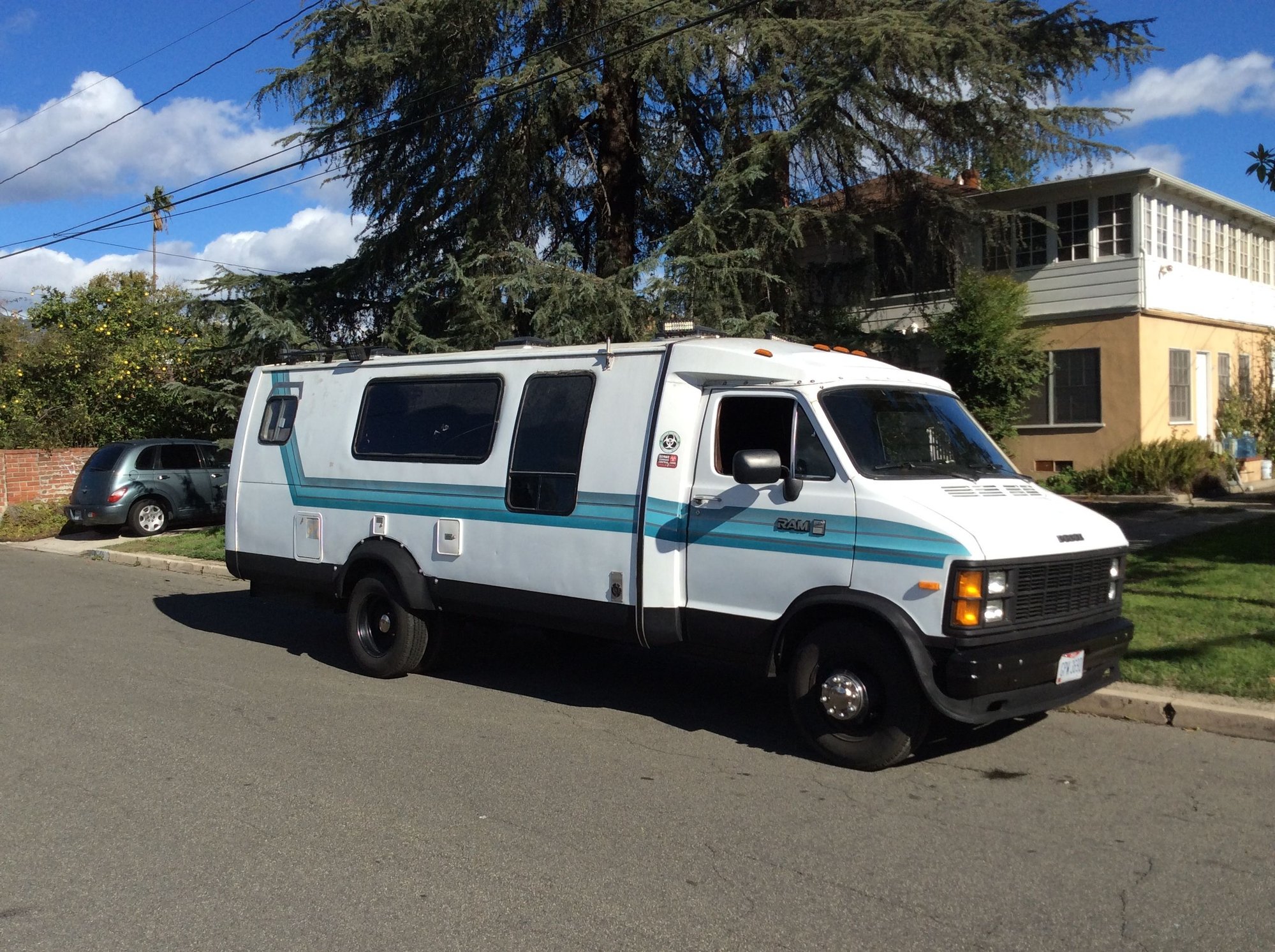

Here is a couple of pics from 4 years ago, I had already done some customizing but it was before I had the roof sprayed
the entire van was painted with a rattle can......well lots of them!
it has a 50 foot paint job, from 50 feet away it looks great! Close up, not so great!
