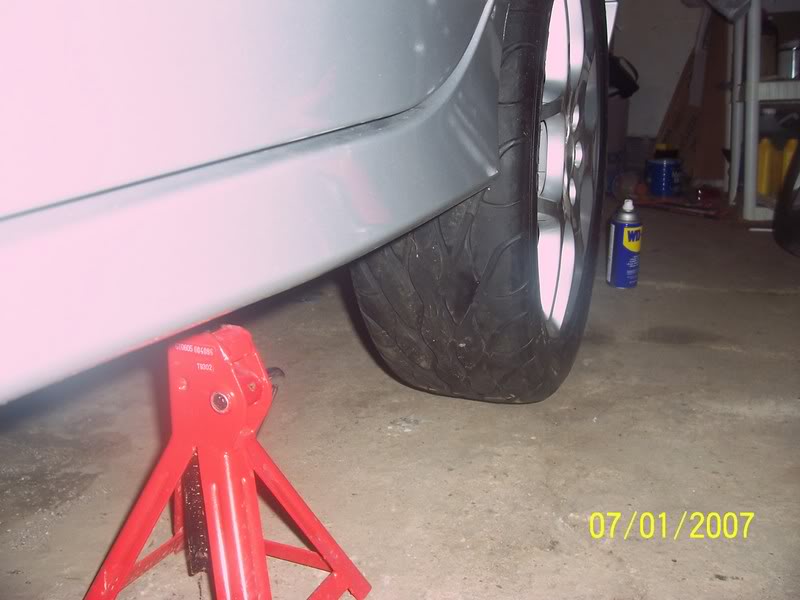

Step 3: Jack up the rear end of the car, supporting it on jackstands

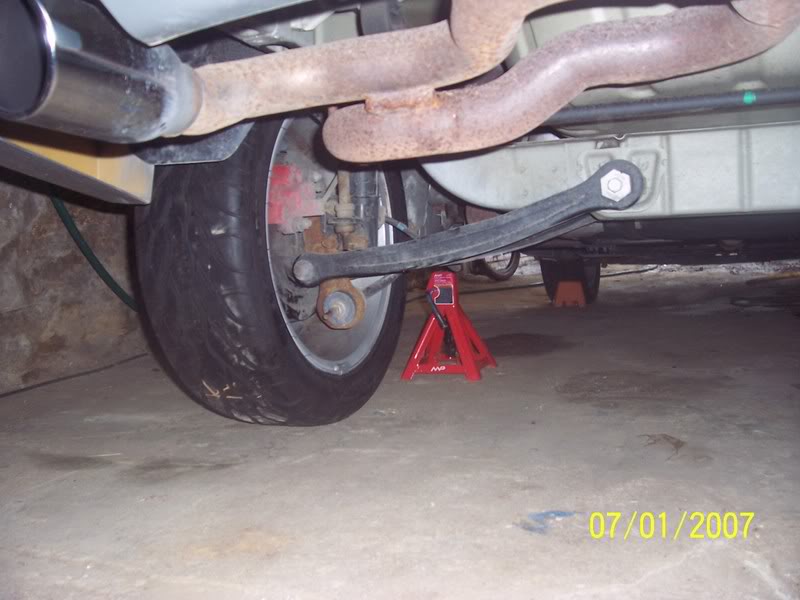

Step 4: Scoot under the car and locate the oval shaped rubber plug covering the hole accessing the disc brake caliper adapter. Remove them and put them somewhere you wont lose them. (They are located on the inside of the brake assembly at the bottom.)

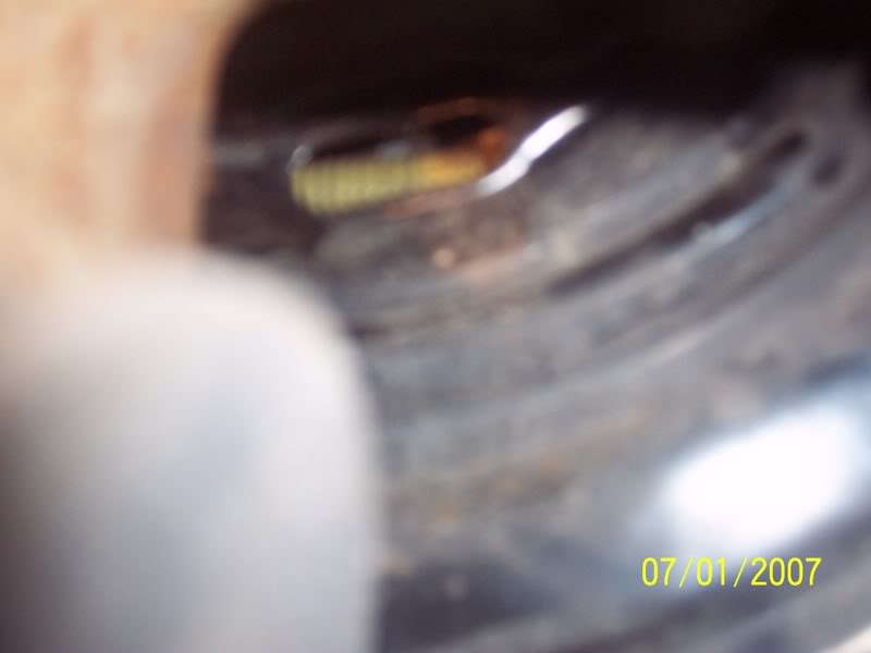

A. Inside the access hole, there is a star wheel just above the spring. Use the screw driver, inserting it through the access hole, turn the star wheel downward until a slight drag is noticed when rotating the rear tire.
B. Rotate the star wheel upward no more than 1 or 2 clicks, backing the brake shoe off the drum just enough to allow for rotation of the wheel.
