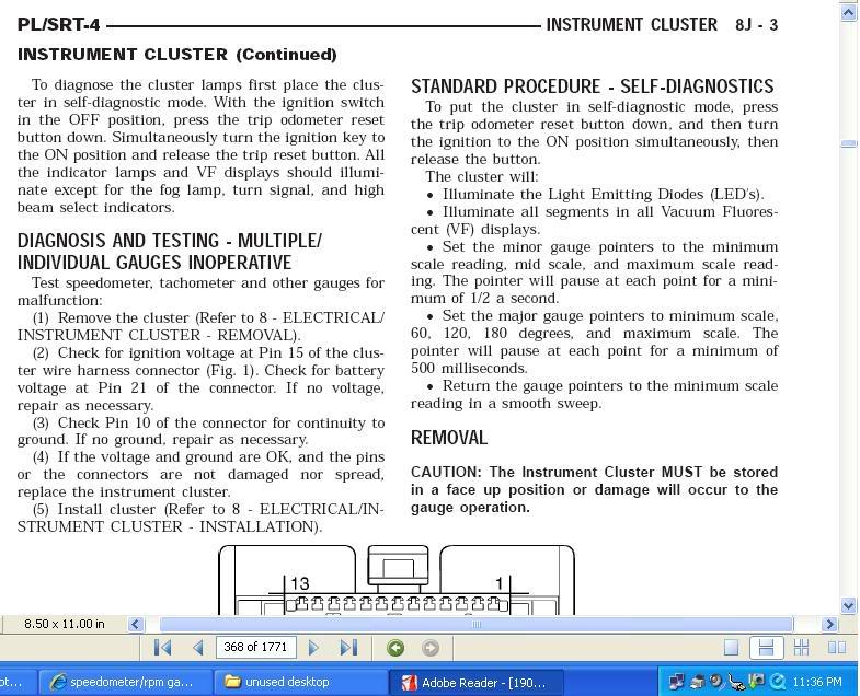

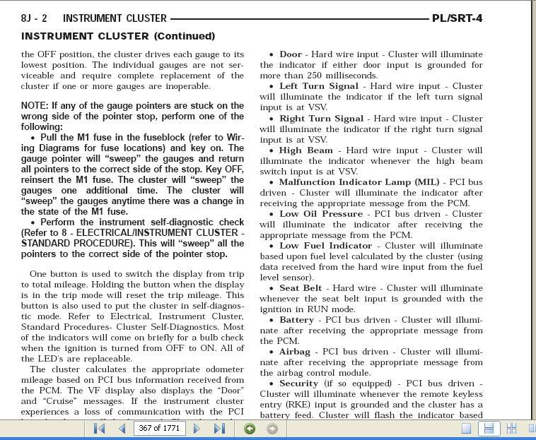

also foudn this in a quick search of the manual:
self test mentioned above:
if you need any additional pages feel free to pm me, ill usually getback to you within a day or so.
