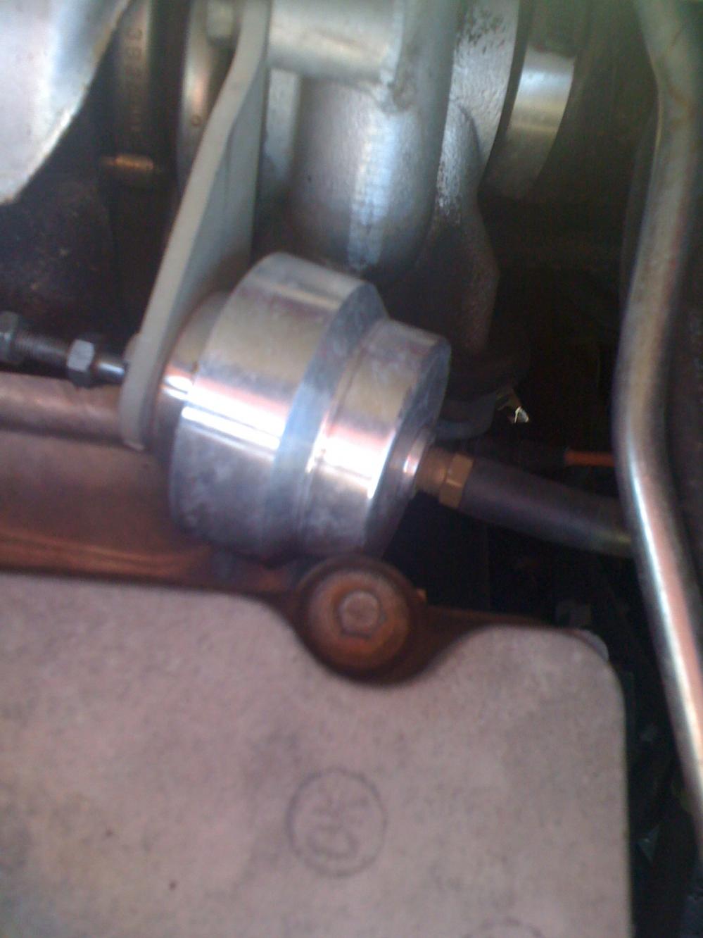

no pump, just the rewire kit. its like 28 bucks shipped from ebay. WPG? ive never heard of them. if you can take a picture of the wga i could tell you what kind it is.

Default here
it is let me know what you think and will a fuel pump rewire really help a lot?

that looks like an AGP one to me. i havent done the rewire yet but i am very soon. everyone says it helps a lot. i would say start by doing the rewire and set your wga to about 19-20psi spike and see how it feels and go from there.
