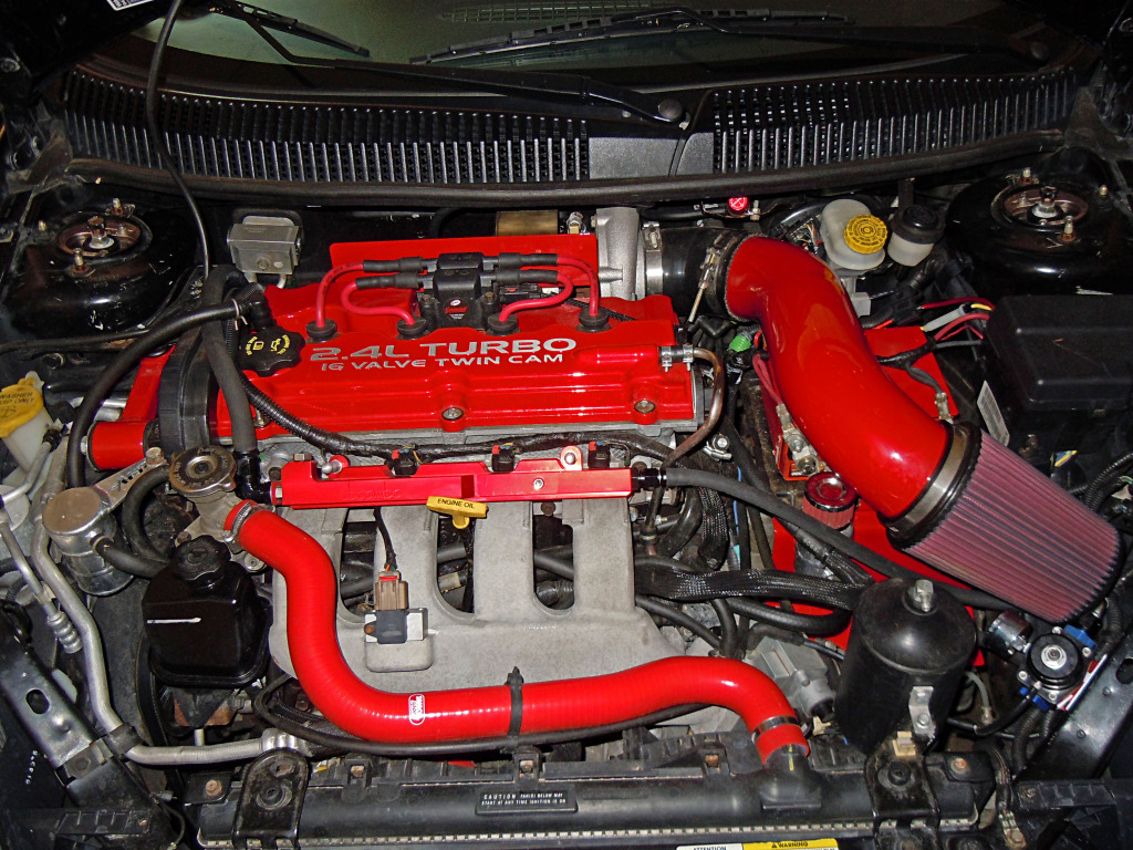

Updated engine bay shot

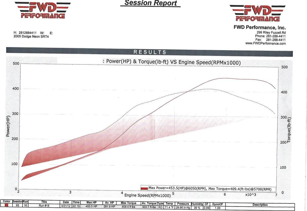

These are my intial dyno tuning results. Both are at only 23psi with the cams set at 0,0. After adjusting cams I will got back for high boost pressure at around 29psi which is what this turbo needs.
First dyno results is with 93 octane.
Second is the same tune but with 93 octane and methanol injection.
