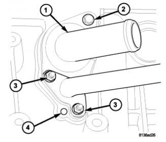

You might want to post up in the Charger section, but a brief internet search yielded this. Google is a wonderful thing:
1. Disconnect negative cable.
WARNING: Do not remove pressure cap with the system hot and under pressure because serious burns from coolant can occur.
2. Drain cooling system
3. Remove radiator lower hose from thermostat housing (1).
4. Remove nuts (2) from heater tube flange studs.
5. Loosen starter bolt at heater tube bracket.
6. Pull heater tube out of thermostat housing and position out of the way.
7. Remove bolt (3) and two studs.
Don't forget to install the thermostat the same way it came out.
Recheck the fluid level a few days later, also. The LH has the heater core way up in the dash, I guess the LX is the same. It'll take days to burp the heater core.
