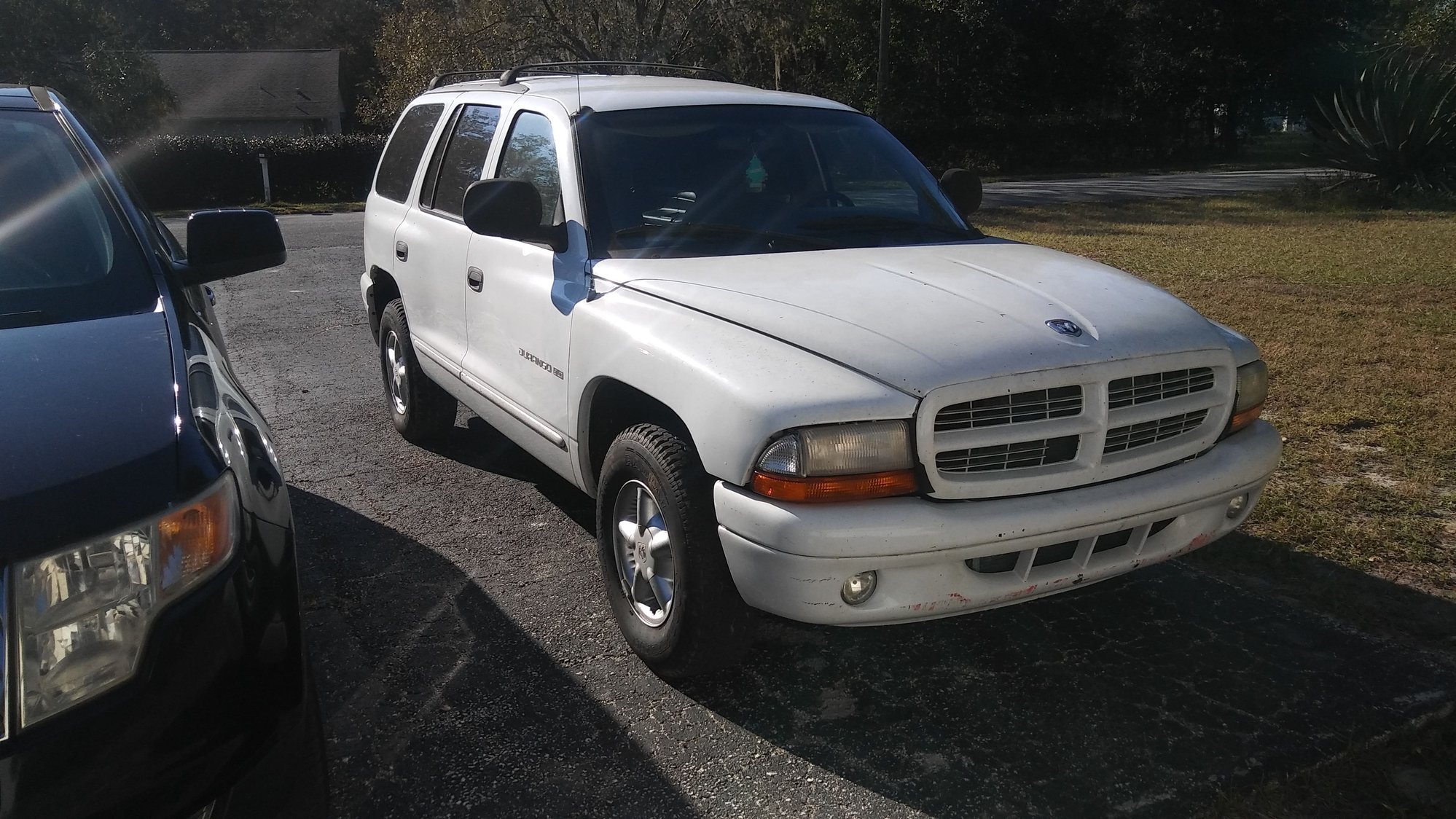

I am new to posting in this group, however i have gained much knowledge from here in the recent past. I have an automatic 2000 durango 5.2 2 wheel drive. I managed to make it from florida to massachusetts using this site as reference. Right now my issue is the security system won't allow the truck to run, which i hear is somewhat common. I have tried multiple ways to disarm the system with no luck. My drivers side lock is broken, i have no key fobs, and i have the black plastic key with no chip i believe. I've tried grounding the light green/orange wire under the kick panel, i tried jumping the wires going to the sensor hooked to the door lock, ive tried pulling fuses and resetting the computer, also have tried locking and unlocking all the doors and hatch in sequence as well. Security light is still on. How can i completely remove or disable the security system to allow the truck to run? I have a decent skill set when it comes to mechanics so that's not an issue. Please any help would be greatly appreciated.
