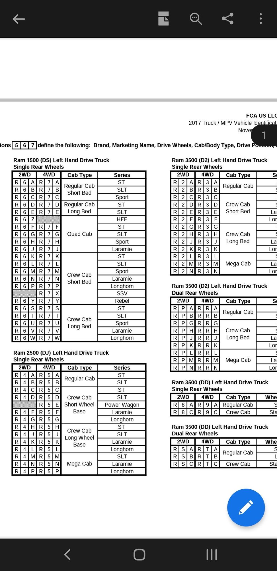

As attached material shows, Ram truck has many code below.
Ram 1500 DS
Ram 2500 DJ
Ram 3500 D2
Ram 3500 DD
I do not what the difference between each code is since Ram 3500 has two codes in this case.
It seems so many codes which starts with "D", so I am confused since I do not know the difference.
Old Mar 31, 2021 | 09:30 AM
Posts: 87,556
Likes: 4,230
Seems to differentiate between weight rating, and number of rear wheels.
DS is 1500, single rear wheels
DD is 3500, dual rear wheels.
Etc.
