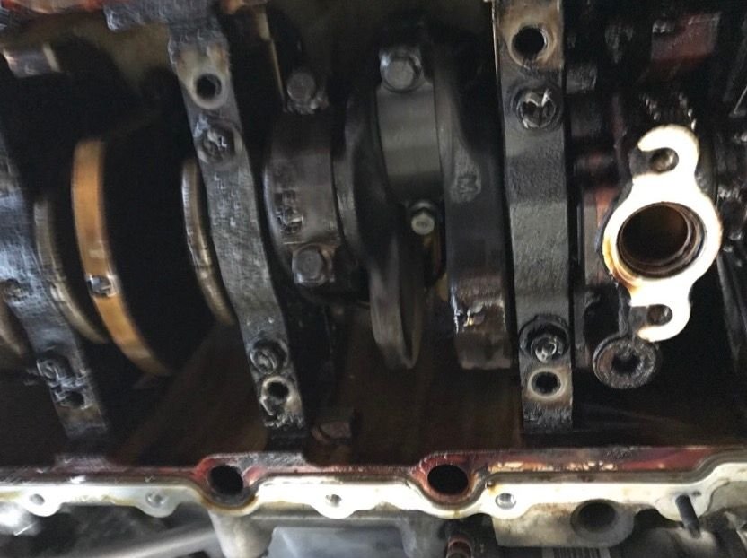

Took it to a dodge dealership had it diagnosed. Dodge dealership told me there is oil residue build up which covered this screen and block oil passage. But that didn't make sense to me because I have my car for 2 1/2 years now, and I do routinely oil maintenance at jiffy lube every 5-8k synthetic.
So I guess my question is can oil residue build if I do routinely do my oil maintenance?
my vehicle is a 2007 charger, baught the car at 89k miles now 118k miles. I feel like I'm being burned by someone

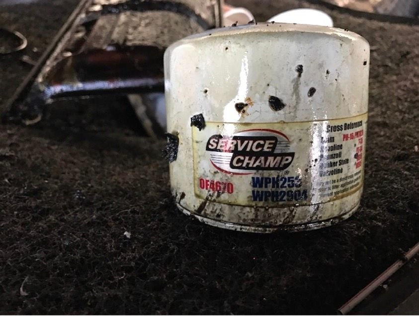

I attached the pictures but is it possible Oil build up can happen that fast? I recently did an oil change 3k miles ago with new oil filter but my oil filter is full of gunk

That looks more like crusty deposits than sludge. I'd say the oil changes were neglected prior to you buying the car. Once this stuff starts, it usually doesn't get better no matter what you do. Repeated clean oil will just slowly flush that stuff into the pan. Looks like those rod journals got smoked pretty good. That engine's done.

Can it be possible that something has failed internally lowering oil the pressure, bolts, clips and seals can break or degrade sometimes or maybe even something has gotten into the oil at some point, perhaps during repairs and helped to block an oil way?
because I never had any symptoms for the last 2 almost 3 years that I had the vehicle that should be alarming but literally 5 minutes driving off the lot engine is blown.
