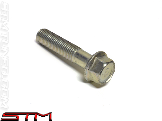

Can you show exactly how the bolt (nr 2, shaft) looks like?
Something like this?
http://www.bouchillonperformance.com/images/BPE4026.jpg
or this
http://images.oreillyauto.com/parts/...at/36275-1.jpg
or
http://www.streettunedmotorsports.co...t_mn119106.jpg
or
http://www.merequipment.com/images/p...ley%20Bolt.jpg
Or is the reverse thread only thing that makes it different from other usual bolts?
What do you think, if temporarily remove the bolt, to take a pic of it and measure the diameter etc, will this screw things more up?
