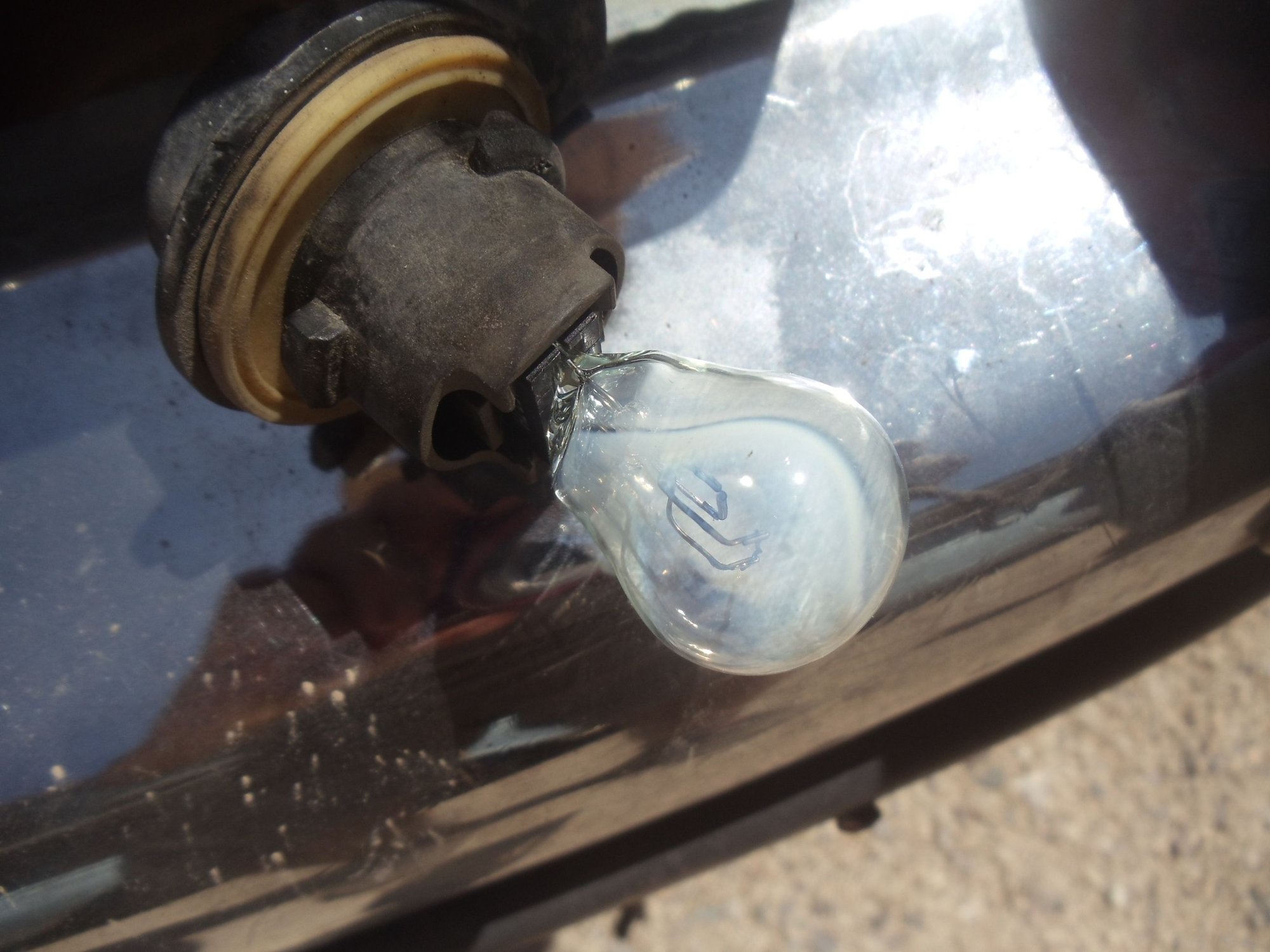

Changed the bulb but the parking light still did not work. Tried the turn signal, which worked, but the new "Valucraft" 3157 bulb spewed out a milky white liquid inside the bulb. I wonder what that is?
First time turn signal tested, bulb spewed out white milky substance.

Like I said awhile back in a previous thread, when I turn the parking lights on, the left green arrow on the dash has been going on. Hard to track down the problem. The wiring for left front turn signal lamp socket goes almost immediately into the wrapped wiring harness.
