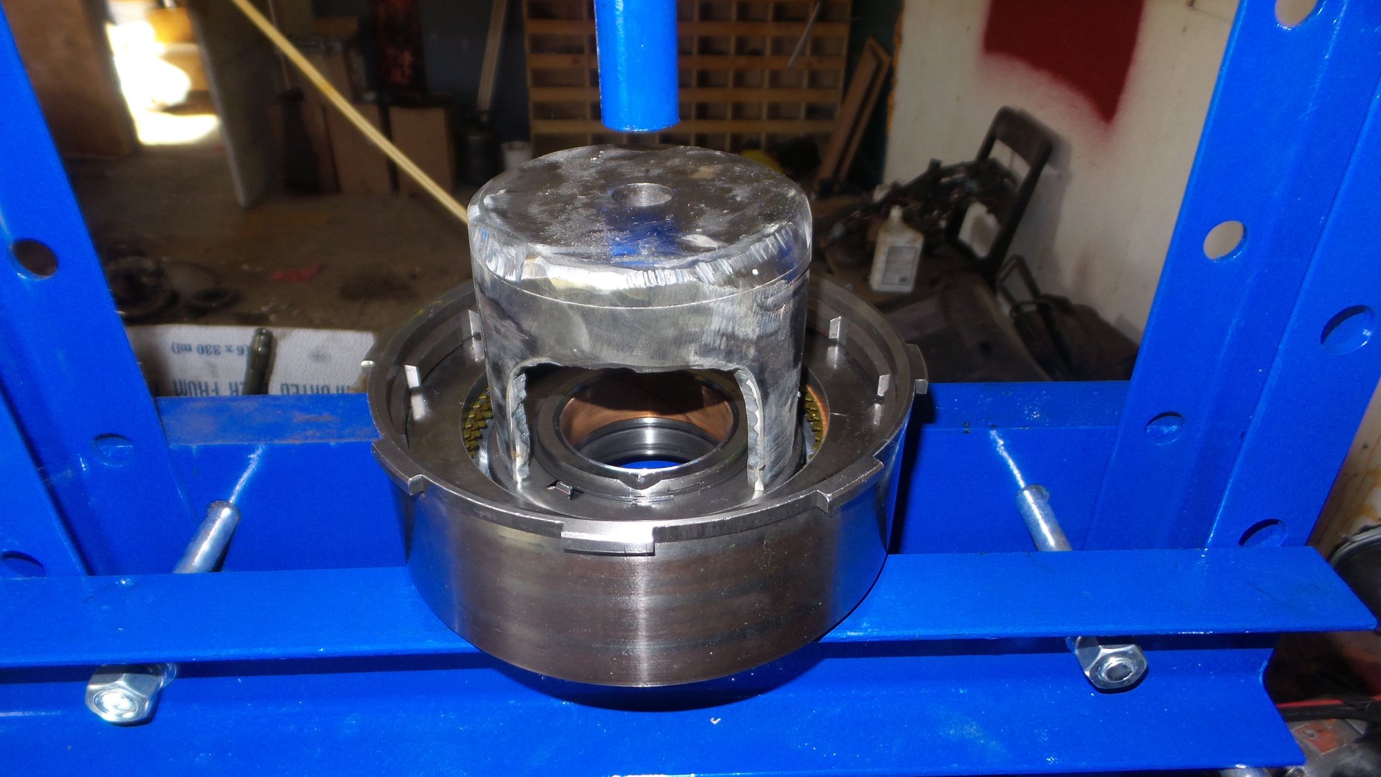

Purchased a cheap hydraulic press from Princess Auto, same junk Harbour Freight sells in the US also about three years ago bought the transmission jack.
The hydraulic press is a joke, once it was all bolted together the frame wobbled, I squared it up then welded the sucker together.
Made this tool yesterday afternoon at the farm.

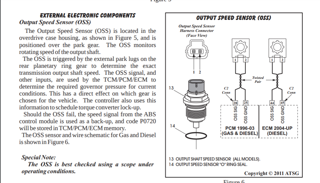

Gear ratio might be, but, the VSS on the 96 is gear driven, just need to put in the right gear.
This is what has me concerned about tire size and differential ratio.
Interesting in that should this module fail for some reason the signal is then picked up off the ABS braking system.

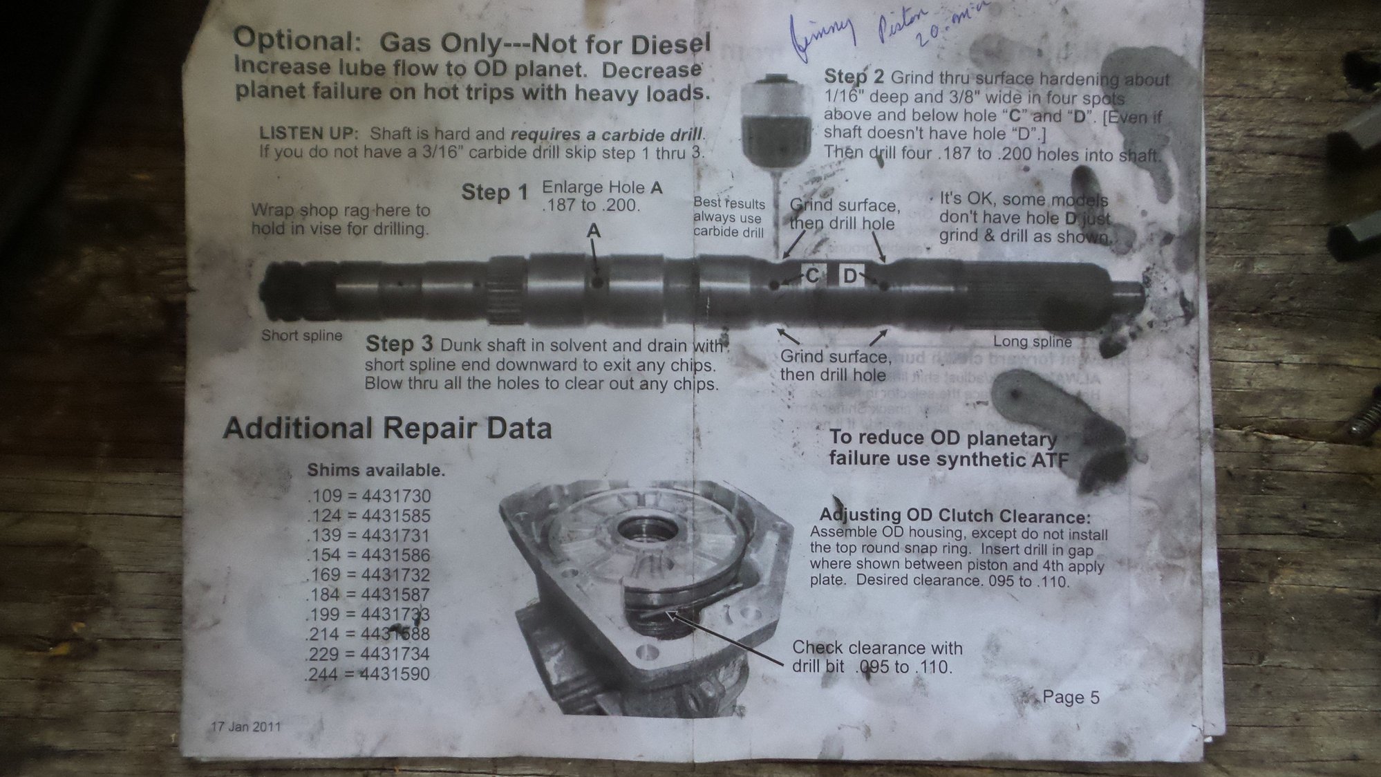

Trans Go shift kit came with additional instructions on how to supply more cooling oil onto the overdrive clutches. Opening up those holes shown in the image below would be a good modification even of your not installing the shift kit.
You'll need a good quality dril lto break through the case hardening.

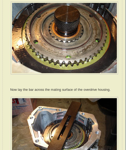

Next tool the Miller Bar, the parallel bar is .500" and the round bar is 5.500" if your reading this you'll know its use.
Half inch cold rolled flat bar measures slightly under .500" if I remove from the round bars total length 5.500" to match that of the missing few thousands of the cold rolled flat bar thickness my calliper measurements should be bang on to use the chart below to determine spacer thickness required.End Play Measurement Spacer Thickness

Excellent document describing how to check the intermediate shaft and the overdrive application piston fro the correct selective end play shim.
The document is complete with charts for the shims.
Ya don't need a miller bar.
Dodge RE end play setup https://www.scribd.com/document/2572...end-play-setup
