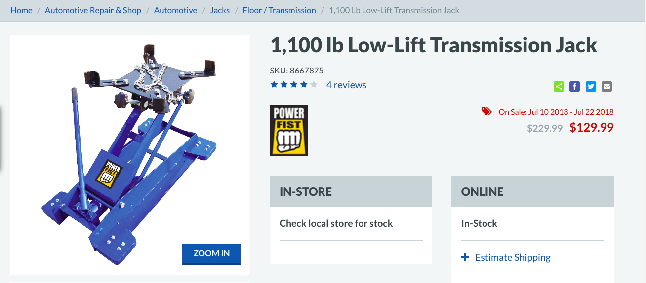

Our Canadian Princess Auto sells the same junk that H. F. offers.

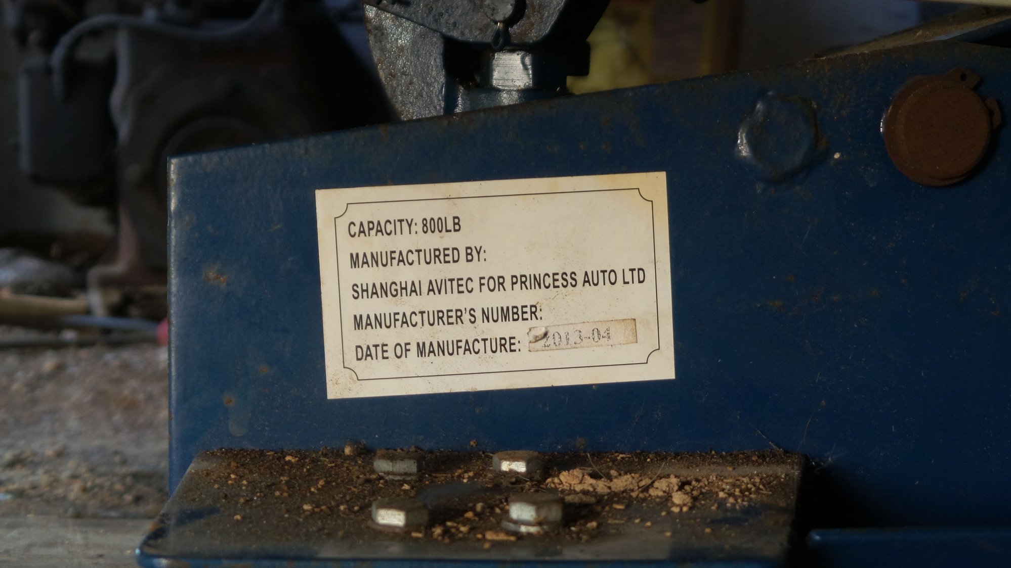

Outside of the box says this jack is good for 1100 pounds, tag attached to the jack inside the box says 800 pounds.

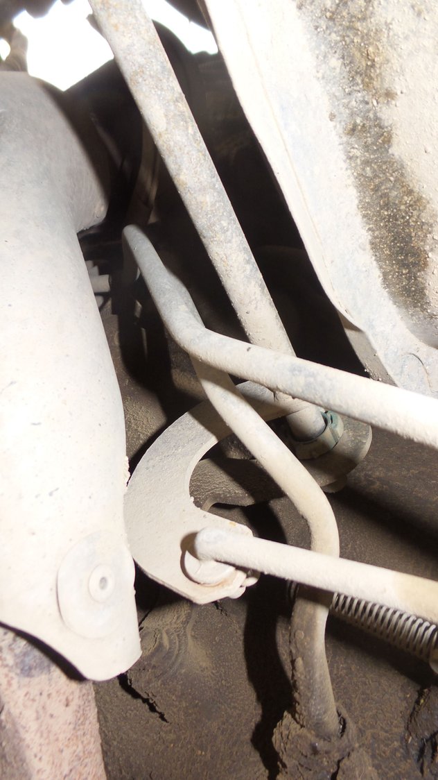

Spent the afternoon cutting a large portion ofr the floor out of the 95 Dakota, truck is being scrapped. This truck is a 4x4 and it's not easy getting measurements from underneath the truck.
With the 46RE being wider in the girth and a tad taller in this middle section a few modifications have to be made to the shifter linkage. From the arm below I have detached the fulcrum, this will be relocated inboard perhaps 3/4/ to a full inch. Once I have the measurements from the 95 I'll know how much the fulcrum has to be moved.
Second problem is with the 46RE being a bit wider in the girth this also adds a bit of height to the beast, the anchor from the 96 44RE when affixed to the 46RE angles the fulcrum rod in an upwards position to where it's obvious that it will bind.

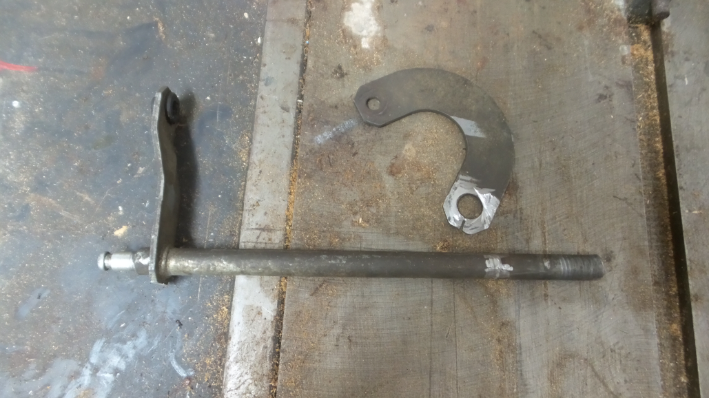

You'll notice that I have marked the position of the fulcrum by cutting into it with a hacksaw so that it may be realigned properly when welded back onto the shaft.

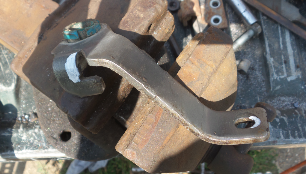

From a spare shift arm support the parts shown in white were removed, beside this slight modification the fulcrum was moved inboard 3/4" then welded back into place.
I'm pleased that everything is aligned perfectly.
