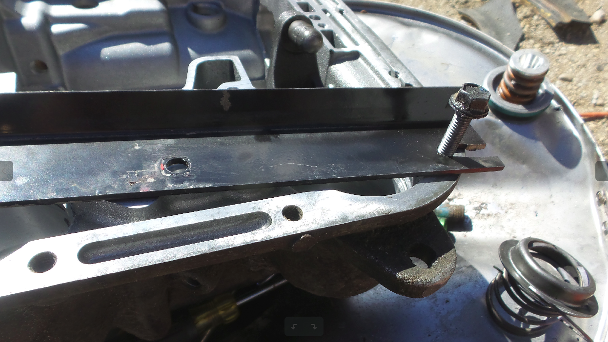

Today my scrap pile came in handy, made this simple tool to compress the spring on the reverse servo while removing the snap ring.

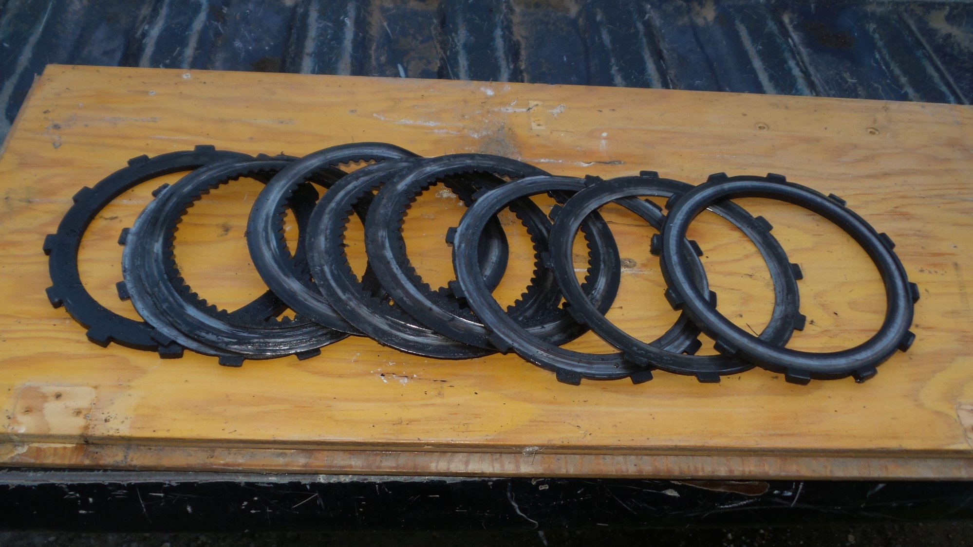

Below are the braking clutches, I'll have the rest out tomorrow afternoon., the slide hammer worked its charm couple of whacks and the front pump came right out.
