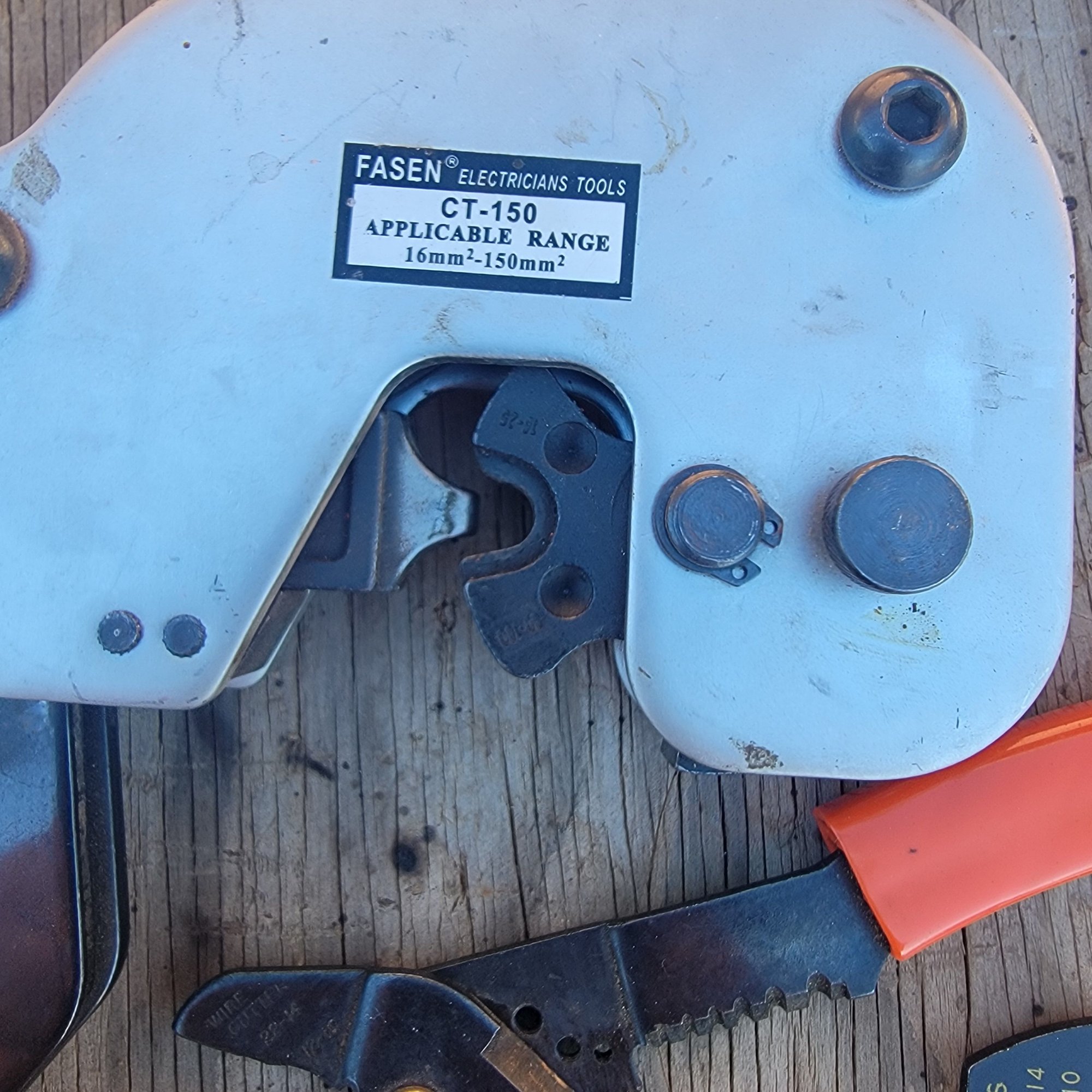

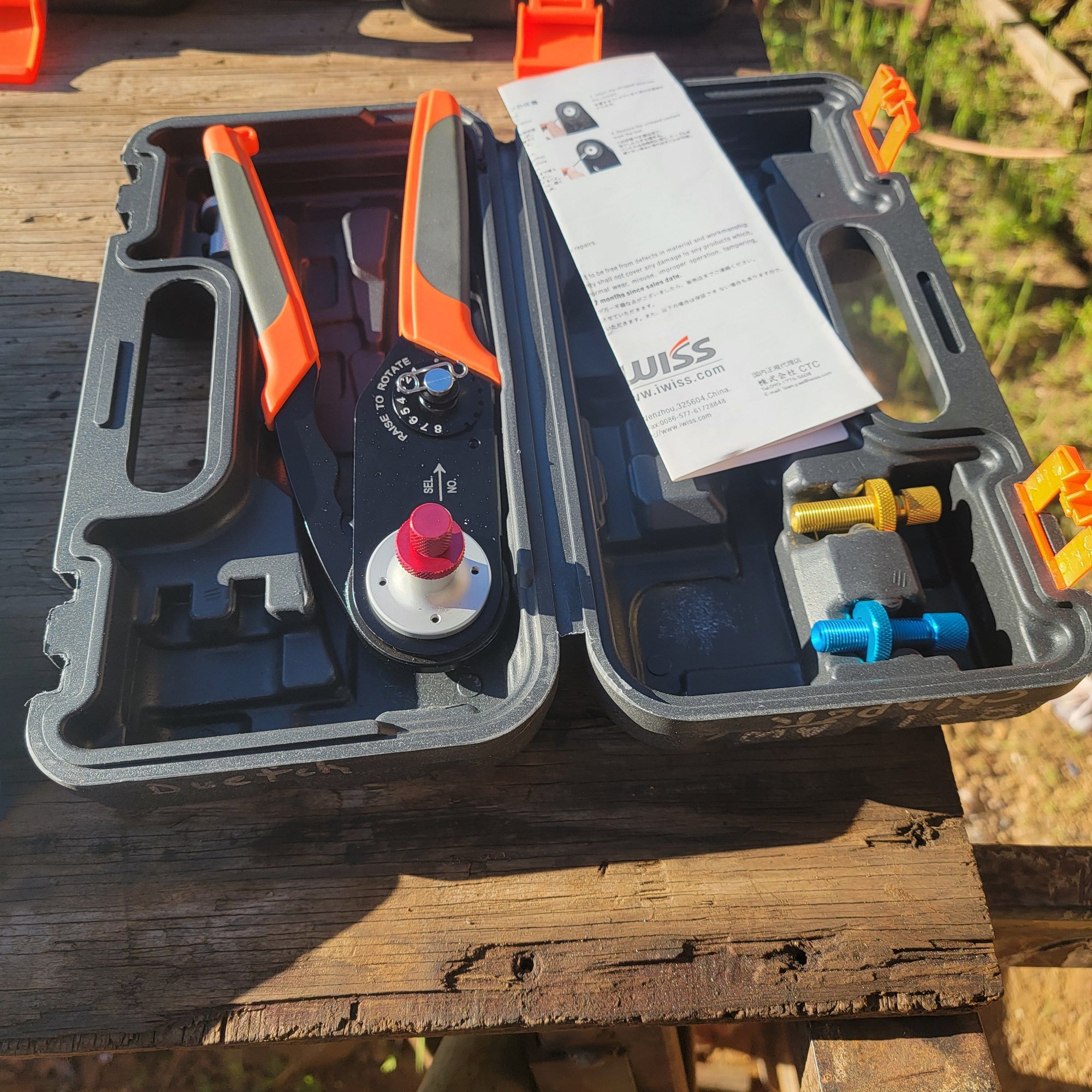

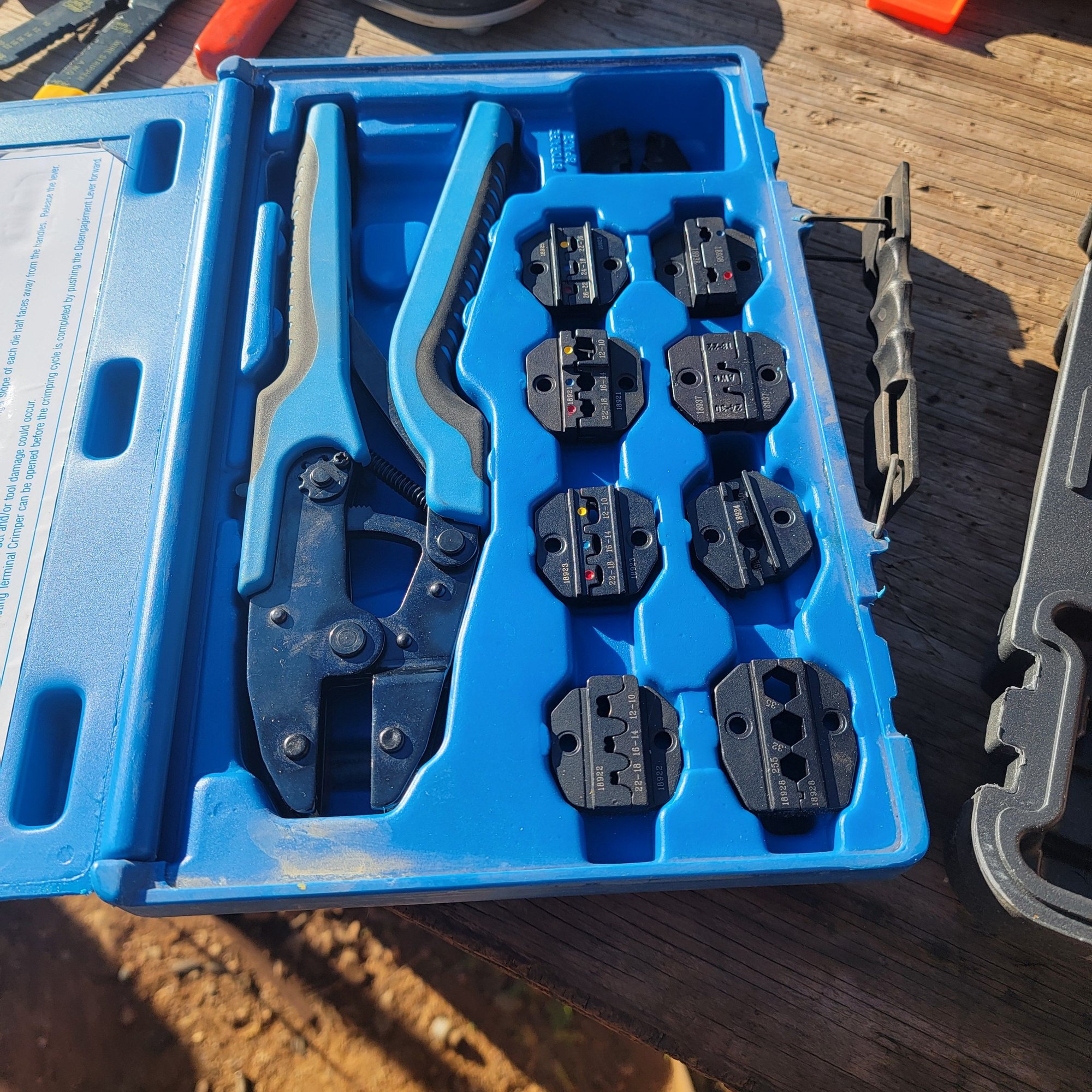

Los control, You are Awesome, I've heard the blurbs against soldering a bunch of times. From it MELTS,(Too small of wires ? He was also saying his wires run hot... hi-wattage sound system) To the getting brittle and cracking. If the solder joint is a cold solder, it can give you some weird readings, same with a loose crimp. I have a couple of those Rachet crimpers, they're supposed to work better(No Over- Crimping), when I try to use them according to the color,(blue is # 14, pink is #18, yellow is #12 ish, red is #8 to #4, my alternator charge wire is a #4 welding cable), it always doesn't crimp enough. And the spade crimper I use sometimes pierces the plastic insulation, the liquid tape can work for small patching.
The pin crimpers, are rachet crimpers, which seem to work more better. Maybe its the four pins.
I have a large cable crimper(Battery Crimps), I probably over-crimp with those.

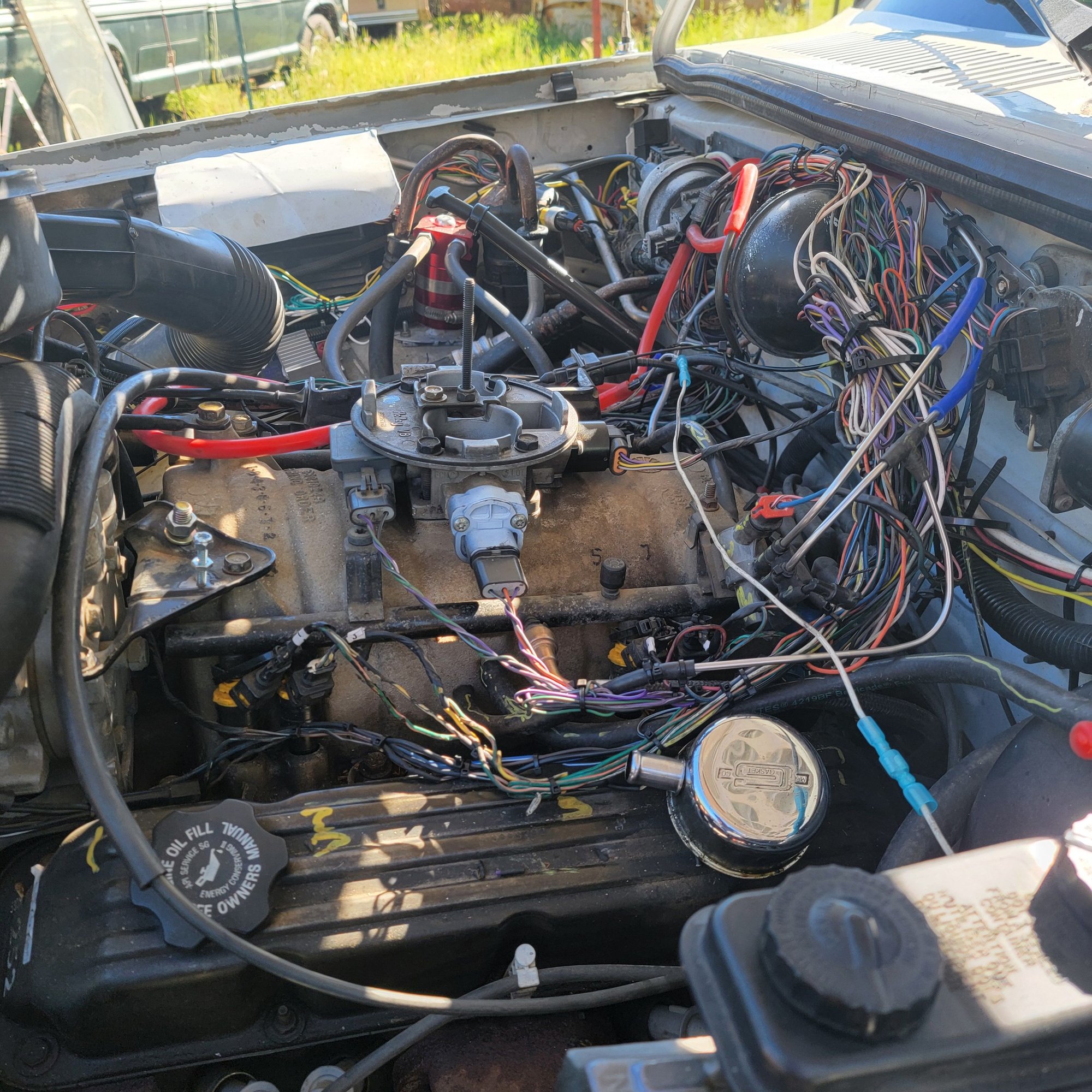

I moved the relative neat wire bundles from in front of my Dak intake and made a rats nest on the firewall, I'll have to shorten them when I decide whichever Bundling technique I use. There were 4 wires that I missed identifying, maybe the solenoids and switches on the tranny.
Too bad there isnt a breakdown of where and which systems the wire colors could be hooked to. I found the splices that were buried in the looms, except the one down behind the drivers side head.

Here is some of my crimping tools.
Cable Crimpers, Battery Terminals

#12 to #8 solid pin Deutsch type connector

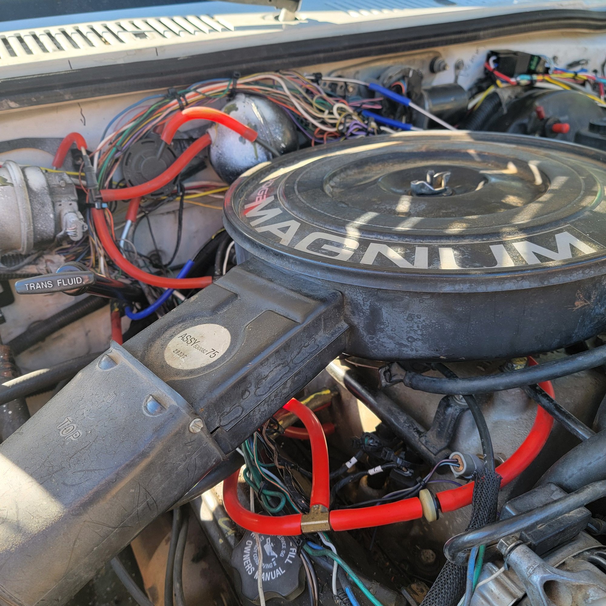

The red hoses will make it run more better and the rats nest
The red hoses will make it run more better and the rats nest. The blue hoses are from the purge valve. The passeger wires are all alone on the passenger side of the engine.
All the wires that go down over the trans are now on the firewall, Not on the engine. The passenger side wires are the injectors, the temp gage, the alternator wires and the charge air temperature. The drivers side wires are the A/C clutch and hi-press switch. the injectors and throttle body sensors. Still need to trim out the extra wiring and bundle them. Some of the wire insulation is brittle, so some patch jobs are in order. I'm planning on moving the small vacuum lines over to the passenger side and plug the other ports, except for the brake booster.

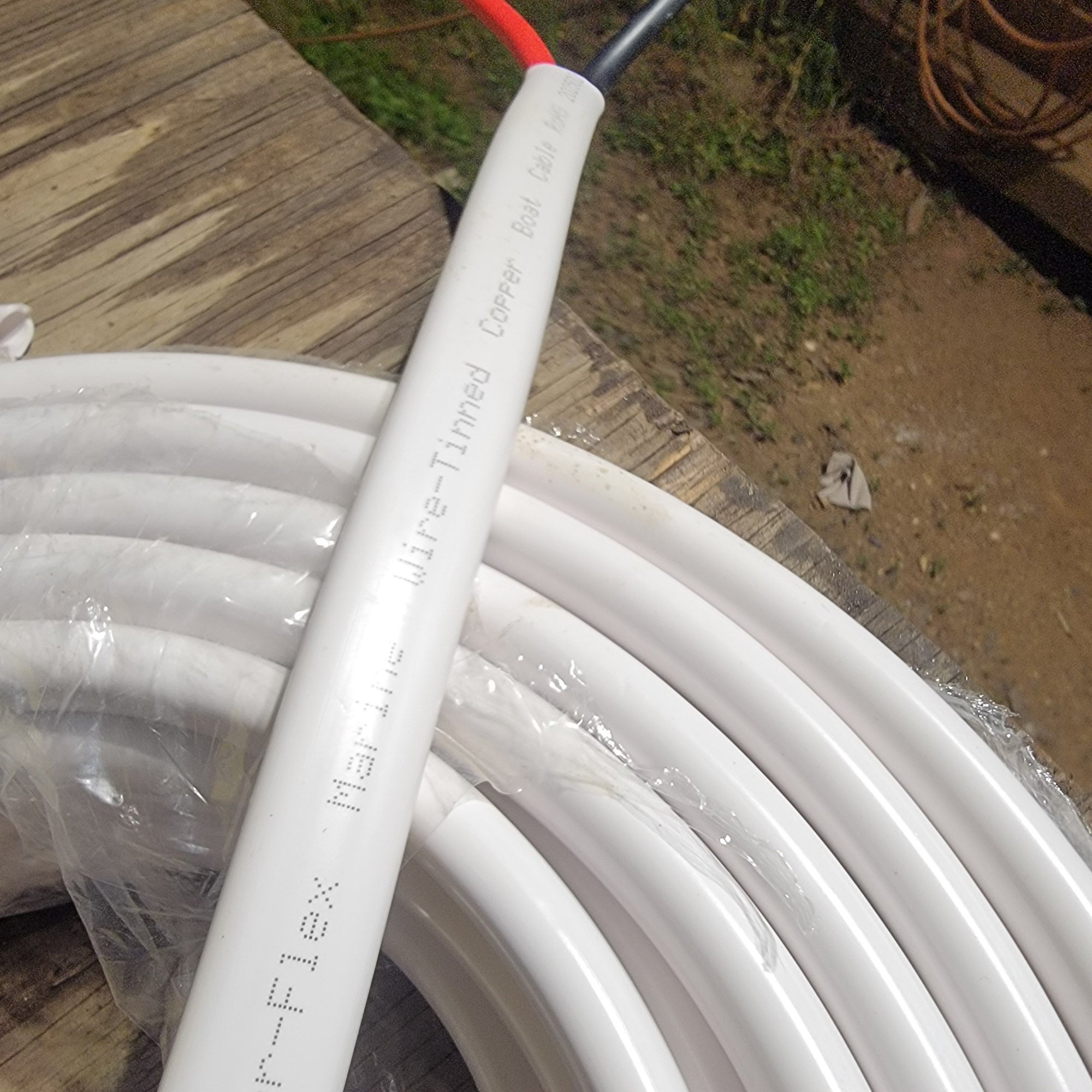

Amazon sells cables with 2 wires together in a sheath. A positive and a negative? Or multiple wires glued together.
2-#8 wires, Power-Flex Marine Boat Cable
Make both positive and negative wires the same size. Sometimes 2/4/6 smaller wires running parallel are more flexible than 1 large wire, as long as the total amperage carrying capacity is the same or greater. The power company does it all the time. OEM companies do the same.
