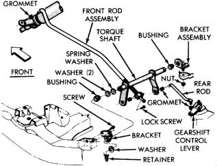

I can't get the blasted shift link out the grommets is there like C-clip on there??

No it just pops off. That rubber is tuff. If you havnt already try penitrating oil. Here is a pic of the set up if that helps any!

Thats what I figured but damn its in there good >=S
