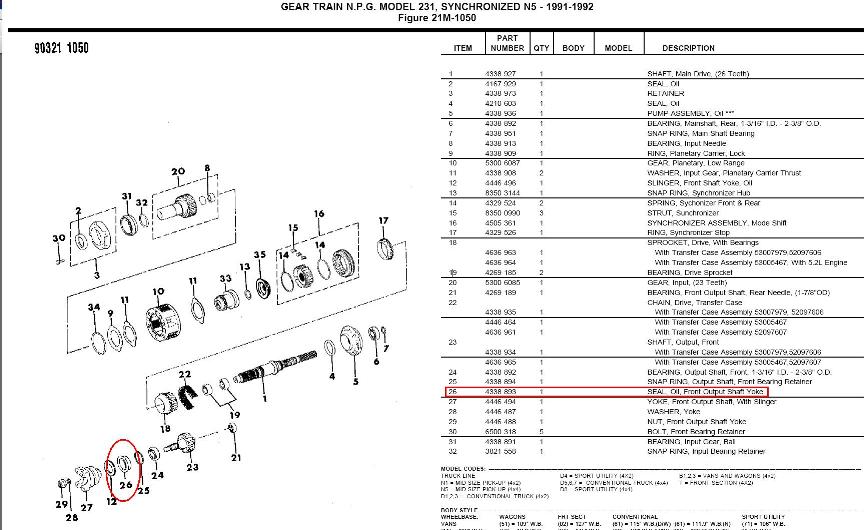

Attached is a pic from the parts manual (you can download one: go to FAQs and scroll down for the link)
The Chrysler part number is 4338893. Expect to pay about $21 at the dealer.
You can get a better price at NAPA. Just have the serial number of your transfer case available (there should be a tag on the rear of the case with model, serial #, gear ratio, etc)
The hardest part about changing the seal is getting the nut off the yoke.
If you need a how-to on changing the seal, I can provide one upon request.
