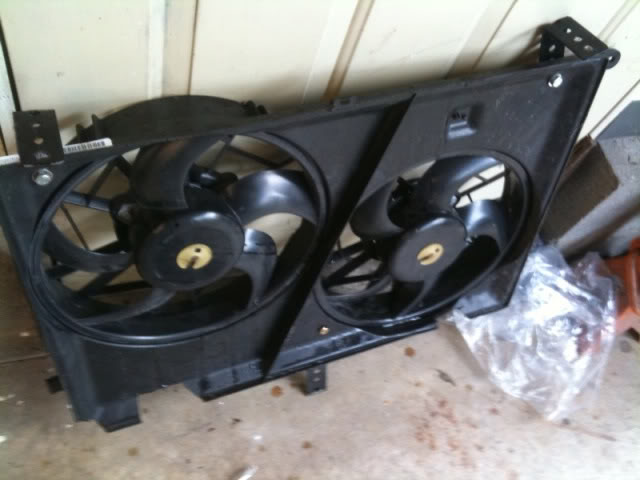

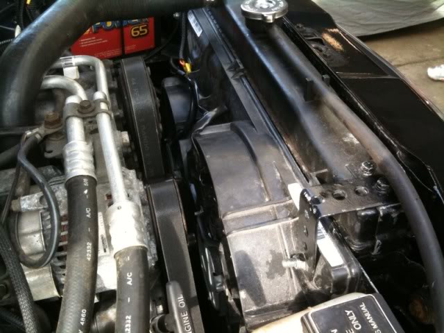

ok i took off the fan and noted
the fans were actually divided into 2 by a plastic lip
so i cut that lip off
and reinstalled for one more try
the clutch fan seems so close to lower rad hose with the body lift
im hoping this will work
i ran it a little it seems better ,
ill give them more a workout tomarrow
