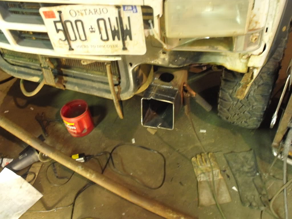

after months of debate, design, and material accumulation, my dad and i got into it today.
we used 3/16th plate, made up cardboard templates and cut and fitted them in flush, and welded them in place with 0.30 wire and lots of heat.
We got the design for the brackets down and the pipes bent.
going for something along these lines, but with less aggressive bends and no prerunner bar
anyway, today we got the frame done, this week the rest of the bumper!!
heres the finished frame rails
