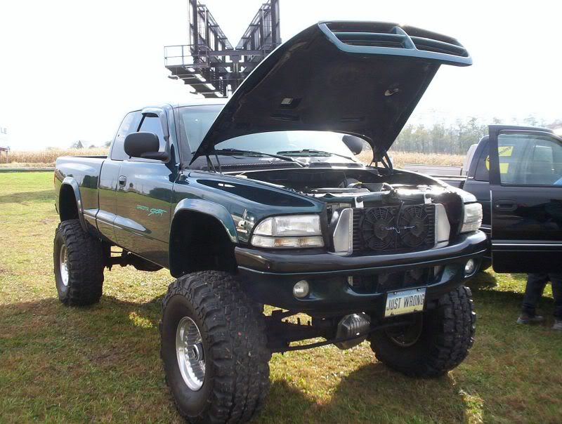

Default This is mine . . .
Old Apr 6, 2010 | 08:51 PM
  #26
BOOMER_87's Avatar
BOOMER_87
Joined: Oct 2006
Posts: 215
From: springdale AR
I hate Diesel pickups!!! But that truck could definitely change my thinking and the stacks are just outstanding......WELL DONE
Old Apr 7, 2010 | 08:54 AM
  #27
6BT-DAKOTA's Avatar
6BT-DAKOTA
Posts: 22
Stacks ? My truck doesn't have stacks . . .
Are you referring to a different truck ?
Old Apr 7, 2010 | 08:59 AM
  #28
95_318SLT's Avatar
95_318SLT
Posts: 4,839
From: Apex, NC
He's referring to the OPs truck!!

Old Apr 7, 2010 | 09:09 AM
  #29
6BT-DAKOTA's Avatar
6BT-DAKOTA
Posts: 22
Oh, Sorry.
That is a nice truck . . . .
