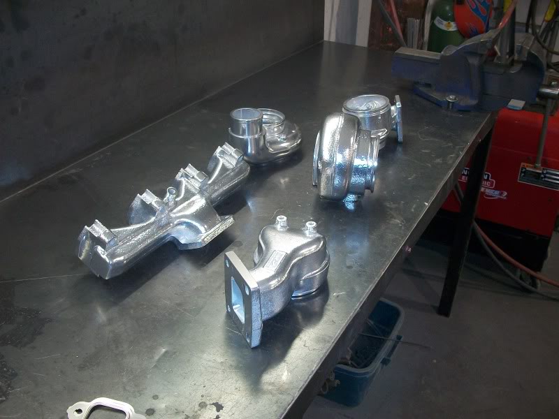

Now some pics of the some "bling"!!!!
All my turbo pieces back from the coaters. My cut 12valve manifold, he341 exhaust housing, he341 compressor housing, ats hot pipe and HX52 exhaust housing.

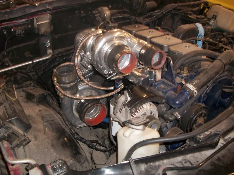

The turbo's installed.
I'm using a 24valve filter adapter and -4 oil lines. The turbo drains are teed in together into the stock drain on the 4bt.
