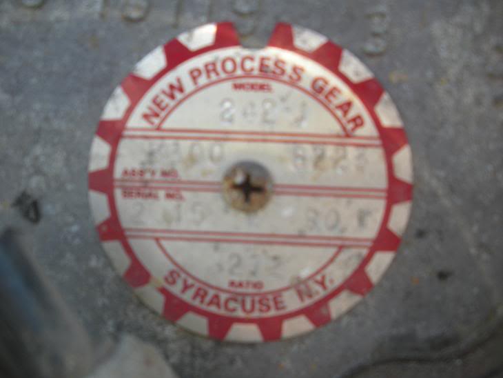

I am wondering if I have a 93 t-case in it. I do know that the motor and some things have been changed in it before. And I just found out that the np231 is the only one offered in the 93. Is there some makings on the t-case I can look for to find out exactly what t-case I have in it?

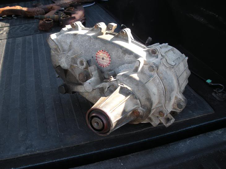

There is a round plate on the back case half that should say what it is. The np231 was the only case offered on a Dakota from '88 to after '96 (i forgot the exact year they offered the AWD option).
This is the tag for my NP242. Yours should say NP231.

Yeah I found that and also found that 93 was the only year they put my transfer case in the Dakota its a np231d. I am being told that is the only one that will work in it. anything else will burn it up. And I think the difference in them is that the front drive shaft bolts on instead of slip in.
