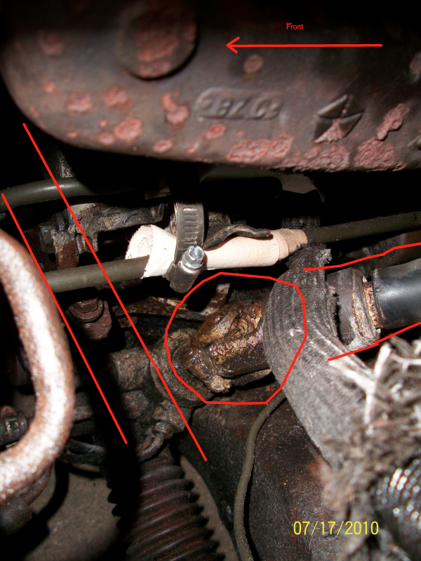

So this is taken from the drivers side of the engine, looking down at the steering linkage. The lines going up/right are pointing towards the steering wheel, and the other lines represent the direction of the gearbox/steering rack.
So the big question...
what's that part called that's circled?
it's like a U-joint but i can't find where I would buy it/who would have it

It is part of the steering shaft. You can not buy it separately. You may be able to get from your local dealer or these OEM sites. But most likely they will be out or way to high. Used will be your best bet. Your local junkyard or www.ebay.com or www.craigslist.org
http://www.trademotion.com/partlocat...&siteid=214583
https://www.dodgeparts.com/oe_parts_...e2cf8fa4e8846c
What is wrong with yours?

it pops as you turn the wheel, so once a rotation about, it pops in and out. I guess it's not like it's about to fall off as far as i can tell.... so maybe just live with it

Replace it even if it is a used one. You don't want it to come appart while driving and you loose all your steering.

what holds that part on? I can see above it there's just a bolt/alan wrench type connecter, but what about below it? do you think it'd be a relatively easy job?

The linkage should be held in with a bolt on each end. (Meaning, a total of 2 bolts, 1 by the gearbox, the other by the firewall)
Pulling that part on my 4WD is easy.

Well 94-up had the bolts. 93-down had pins. So you have pins. Here is a pic from the 95 manual. Where the bolts are you have pins see the red arrows.
To remove the pins use a hammer and punch. It can be stubborn! A air hammer with a point tip will make easy work of it.
Your going to want to find a similar truck, ie a 93-down 4wd. The newer years with the bolts have a shorter steering column hookup where the splines are.
Here is your pic with the blue arrows pointing at your pin.
Here is copy and paste from the service manual. Remember you got pins not bolts.

That is the steering coupler and it is available as a kit from your local dodge dealership. I have tried to find aftermaeket stuff but to no avail....Stick with oem.
