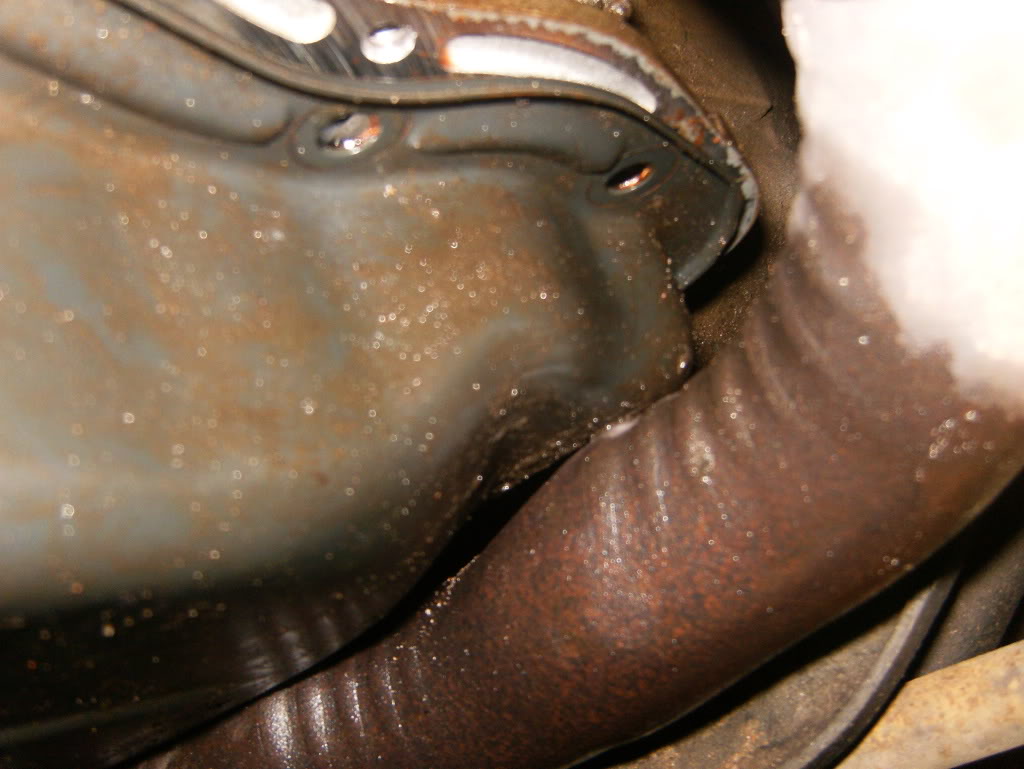

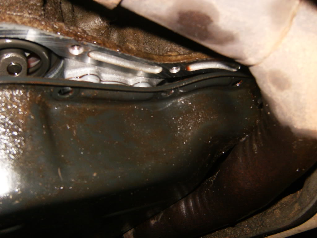

iirc it was about 3 years ago when it was serviced last when the previous owner had it. are there any tips on removing the tranny pan cause it looks like the y pipe goes right over one side of the bolt on the pan would i have to remove it

The best way is to use a ratcheting wrench. Or you can remove the exhaust pipe or just unbolt the exhaust manifold bolts to the pipe. Good luck.

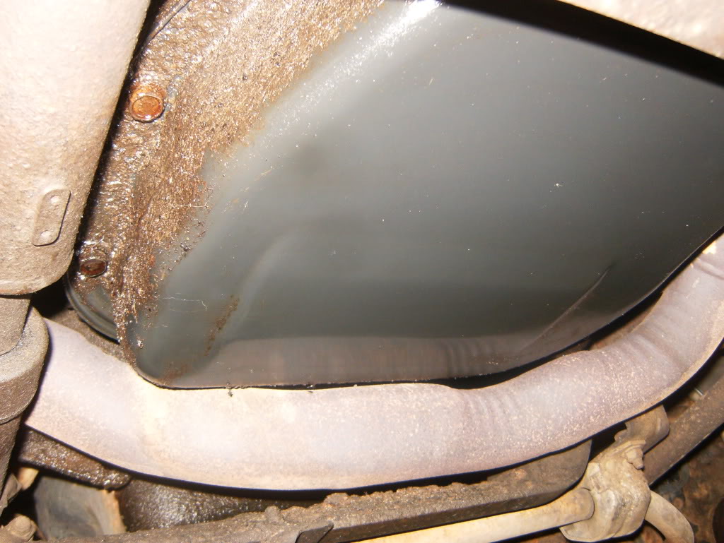

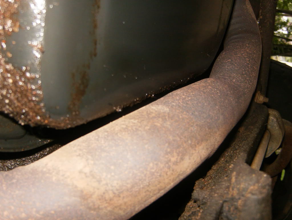

Update: got the tranny pan unbolted last night and ran into problems getting it off the pan is stuck between the tranny and the y pipe looks like ill have to drop the exhaust was hoping I didn't have to do that but what ill do what I got to to get the truck back on the road ill have pics up later tonight of what I mean
edit: the upper corner of the pan is where its catching the y pipe
