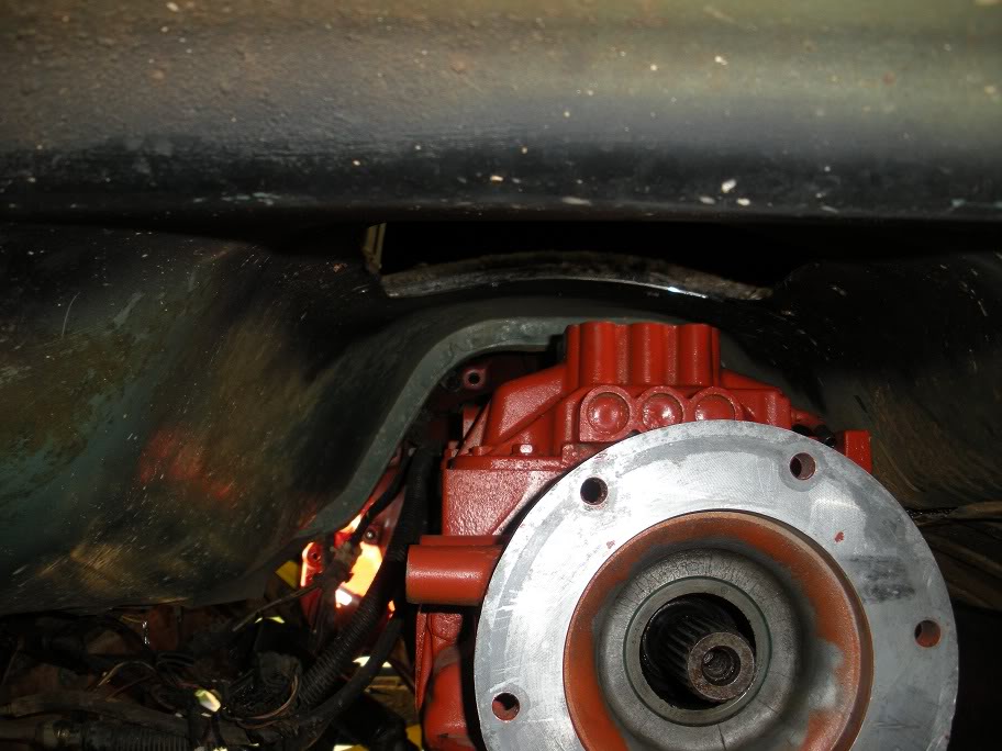

As you can see in the below picture, the transmisison crossmember mounts don't even come close to lining up. This is not an issue for me cause I have to build a custom crossmember anyway to clear my 3 link. It may be a bigger problem for someone else trying this swap.

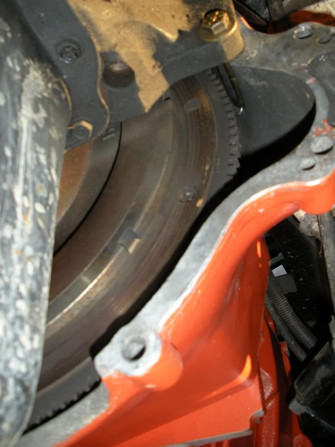

As you can see in the two pictures below, the flywheel fits just as it should in the bellhousing.
