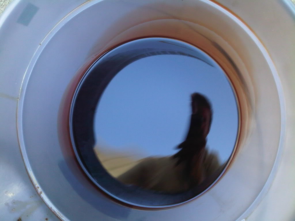

I tried to capture the color here. it has that shiny murky look so it. its still red tho, not black

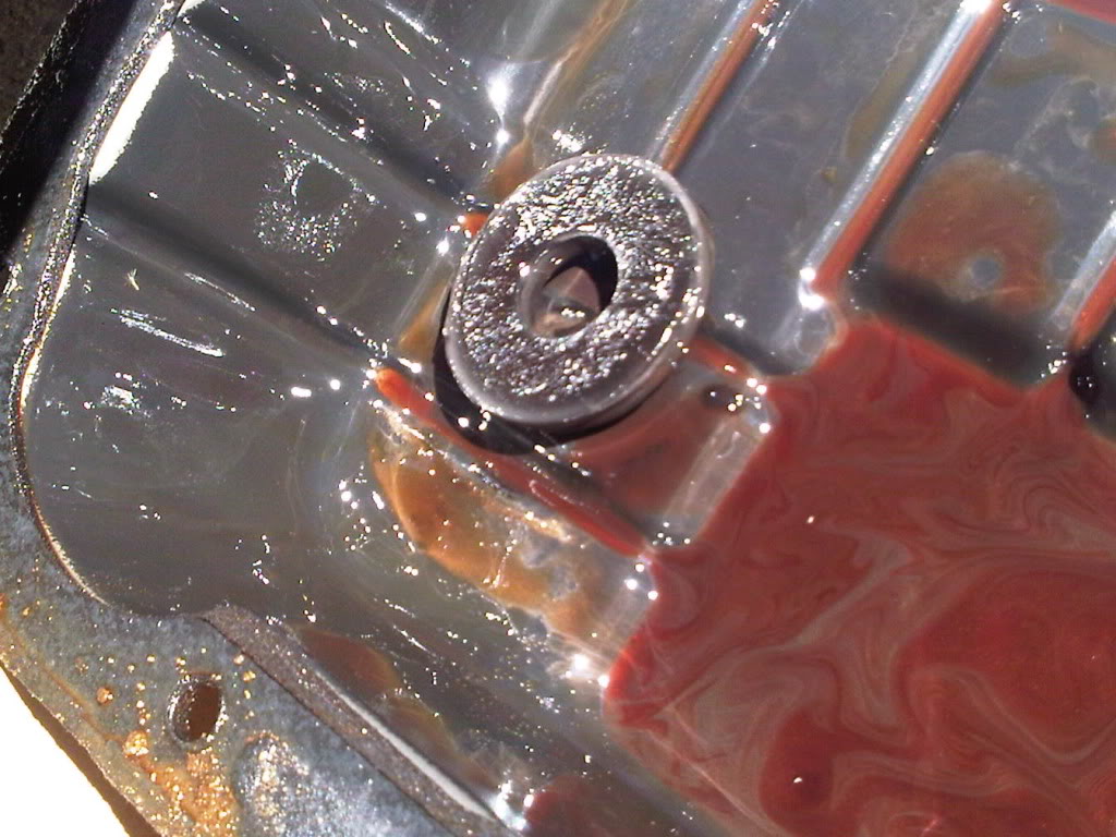

the inside of the pan after i got it down
