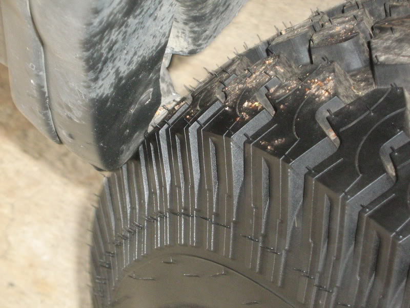

even when I did my lift with the keys and blocks then the body lift I still had to cut the corners of the fender so the 33's wouldn't rub. here is an what I mean...

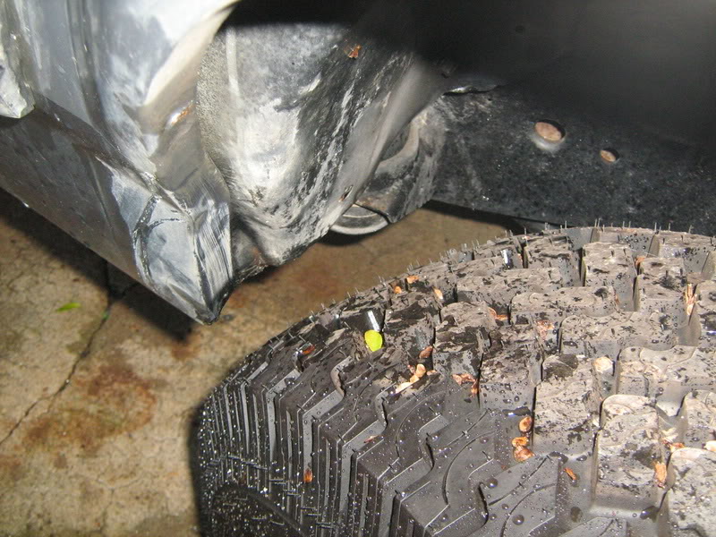

And what I cut
