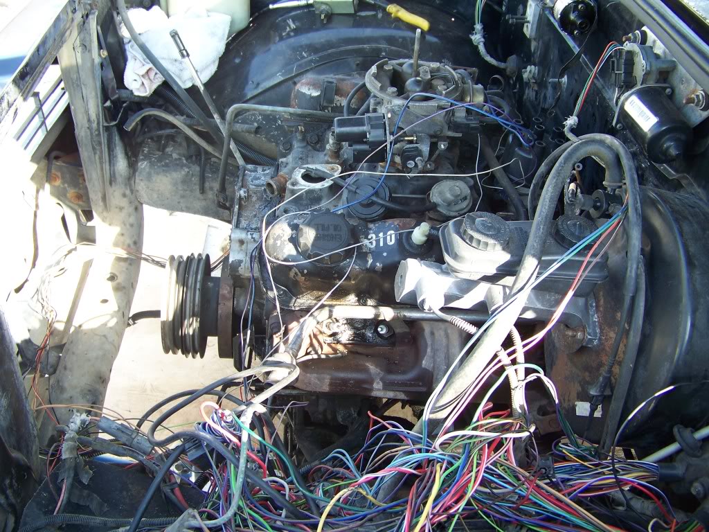

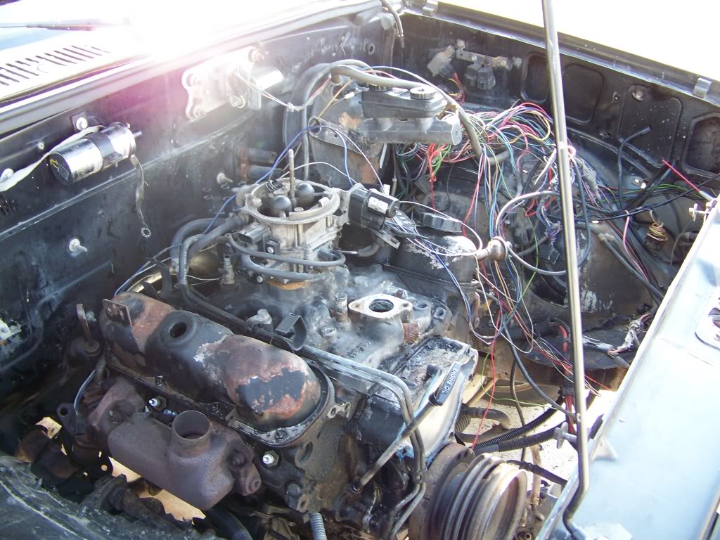

No more ECU. I am still waiting on the hoist to get here to pull her out. I thought I would expedite later things and go ahead and start on the wiring.

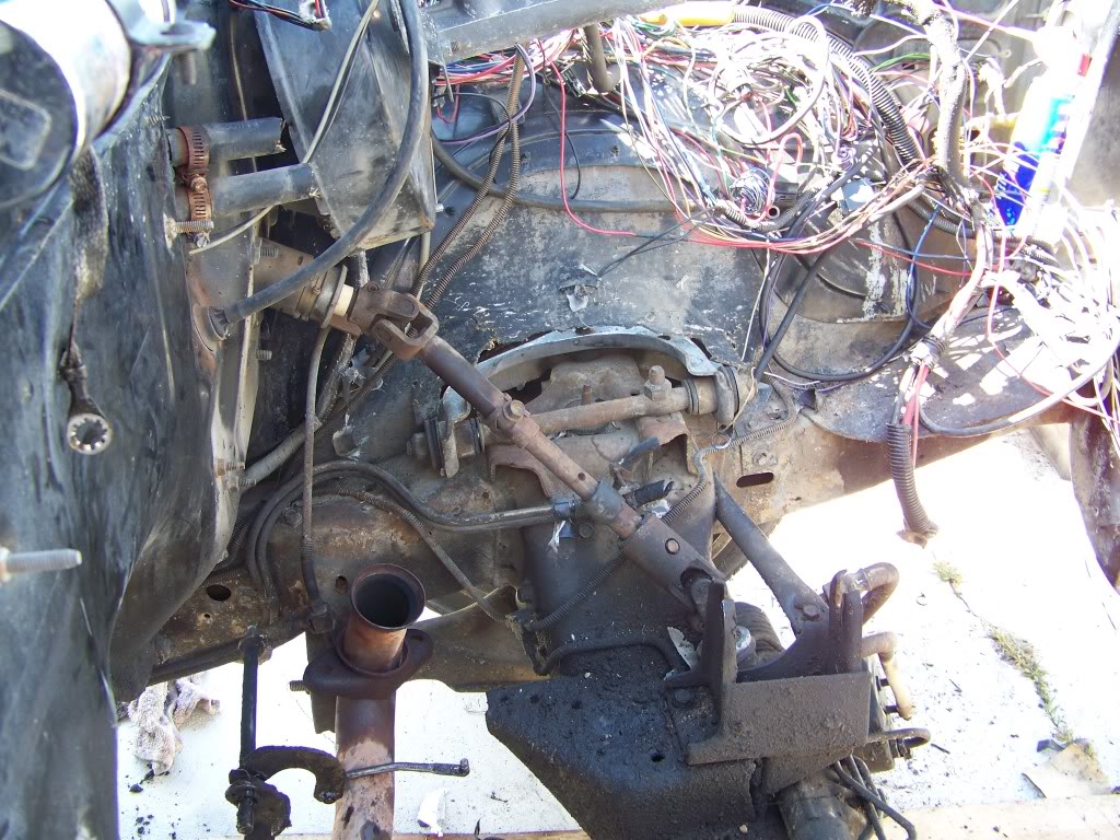

Just an update for those that want to know what it takes to remove the engine.
I used the cross headbolt holes for the chain.

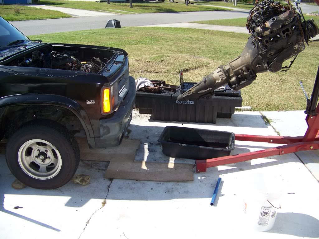

Then I proceeded to pump. Pump a little then pull forward as the pans begin to clear. This is an excellent lift option for 2wd Dakota's.

You will have to lift the tranny out at some point by hand. FYI, I did this by myself, because noone wants to help when real work is being done.

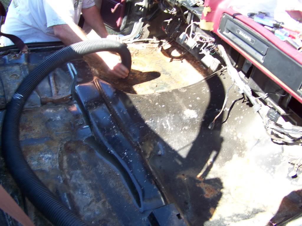

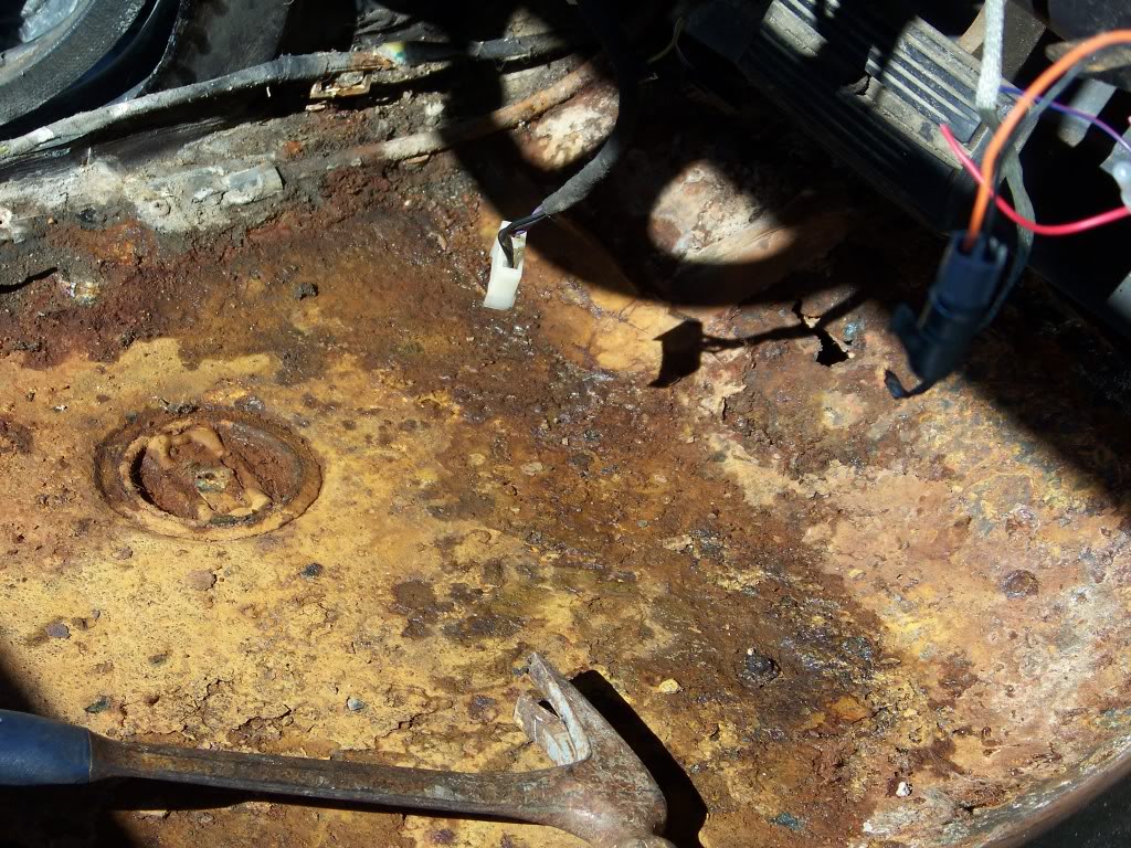

Look what I found. I guess the previous owner was unaware of any rust on the floors.
