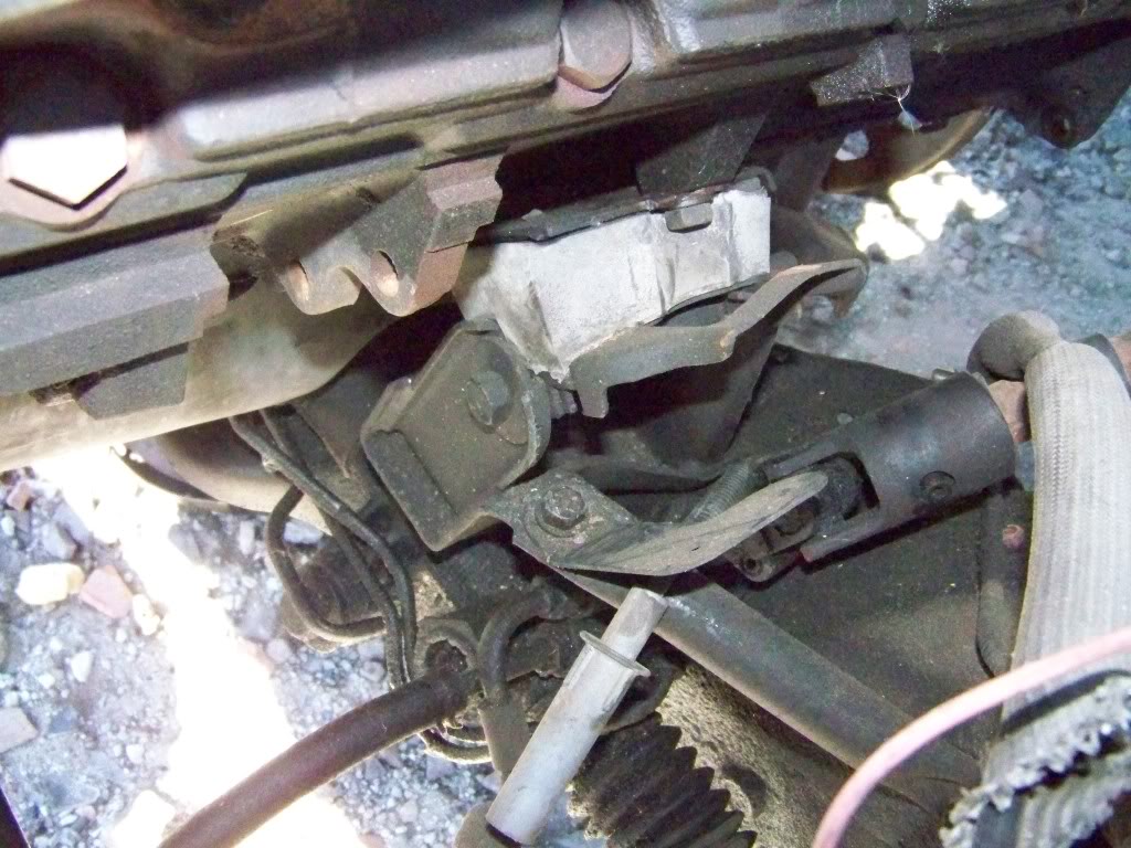

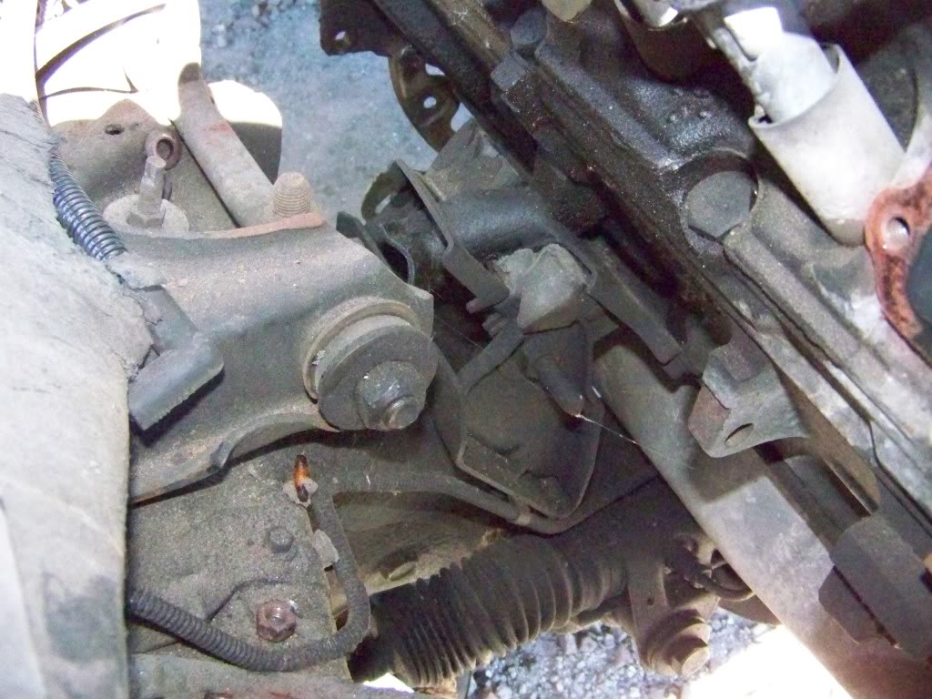

Here are the stock mounts from a 92 Dakota, which are very different from mine. Should I just swap to these?

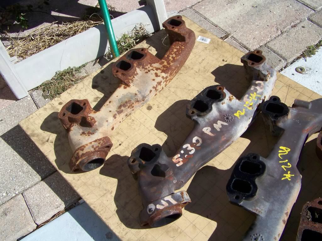

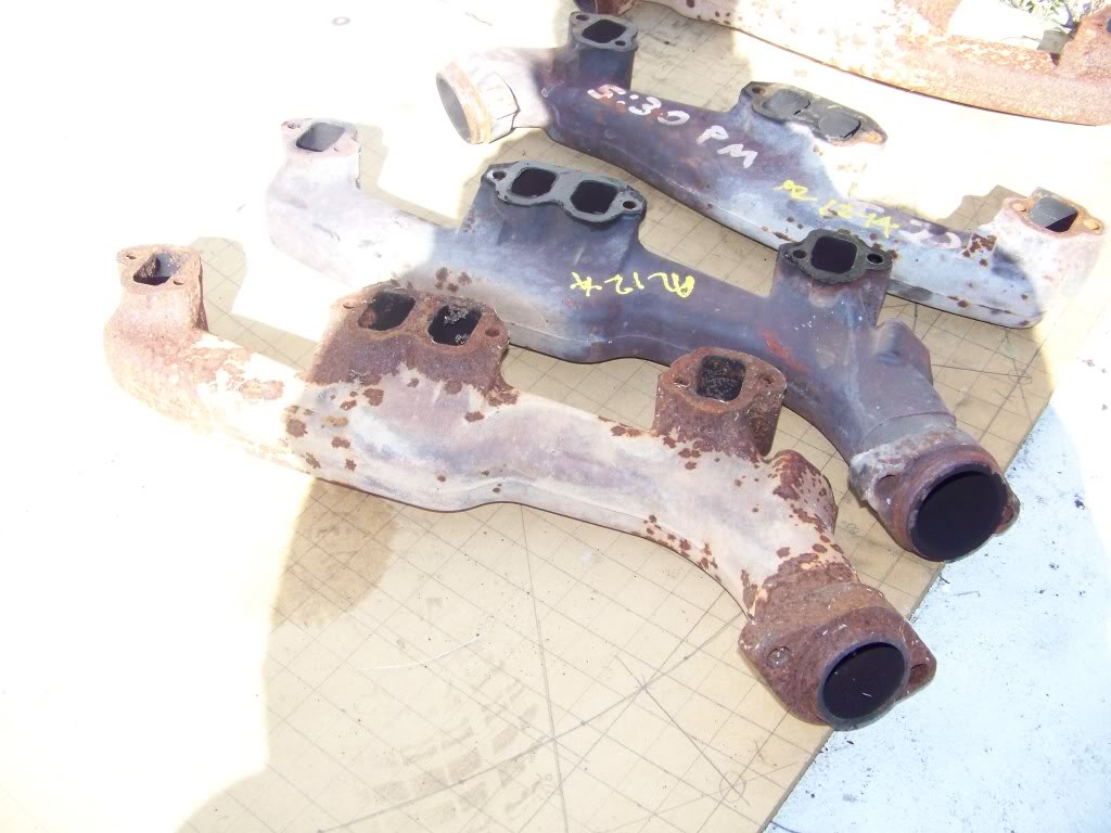

And these are the manifolds off the same 92. Just a rough comparison between the two.

The motor mounts look like they bolt up to the same location to me. But I can't see it in person so I can't say for sure.

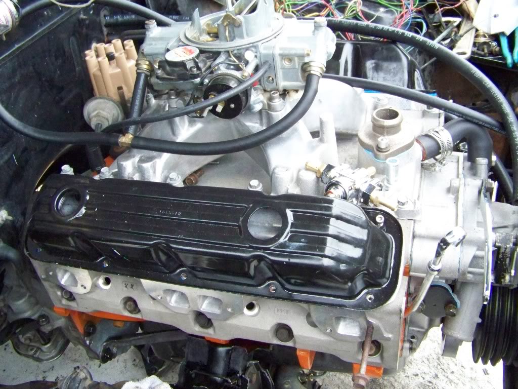

Started routing the coolant lines and fuel lines. I am really getting behind on this thing, but regardless:

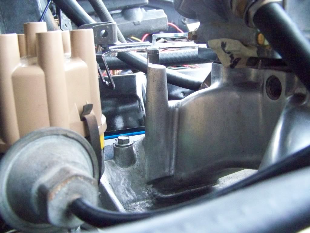

This is the rear of my intake (of particular interest here is the EGR port). After reviewing the functionality of PCV systems, I would like to take advantage of the port and use it as a full vacuum port (FVP) for the PCV and bypass the FVP on the carburetor. Any input here is appreciated.

It occured to me recently that some of you may be wondering why I am using an EFI manifold for a carbureted engine. The fuel port area is for a DP nitrous install later. I hope that clarifies the reason. Although that will not happen until the Fall. This manifold (M1) is also the older square bore 4v style that I do not see alot of from looking at other builds (being they are typically 2v (the newer ones and negates the 2v conversion piece). The air cleaner bolt, as is, is about 1/2" from the hood.

did the carb mount to the intake alright or did it need an adapter?
