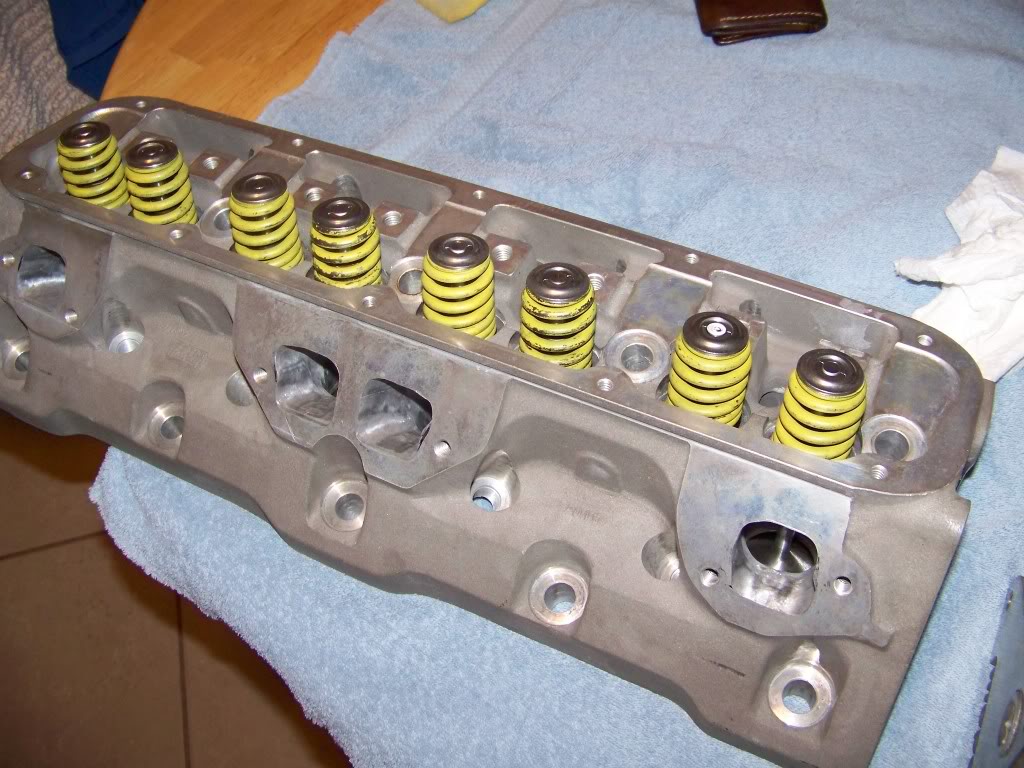

For those looking at LSX springs with Mopar valves, for your viewing pleasure.....

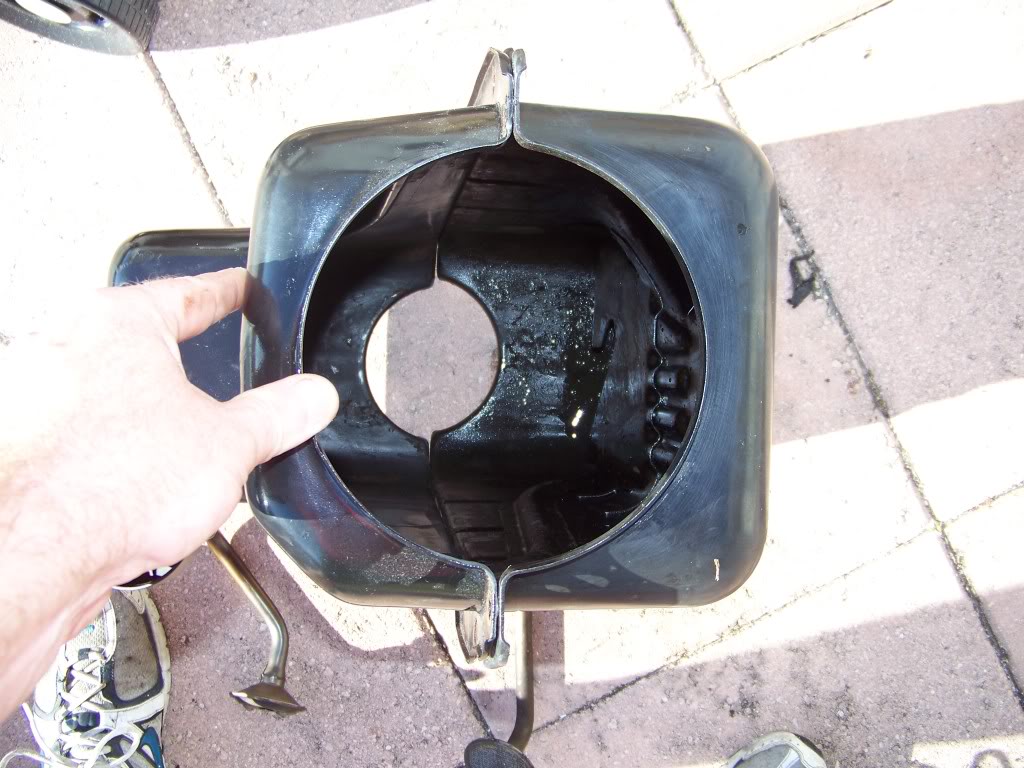

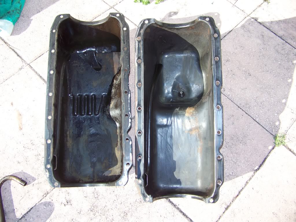

A definative view of the difference between Ram pans (5.9l) and a Durango/Dakota Pan (coincedentally a 5.2l).
Note the depth difference I am able to use a windage tray with the Durango/Dakota pan
The Dakota Pan has a "built in" windage area
The Ram is 95 the Durango is 2000. They have identical openings.
Another side view contrasting the depth and difference.

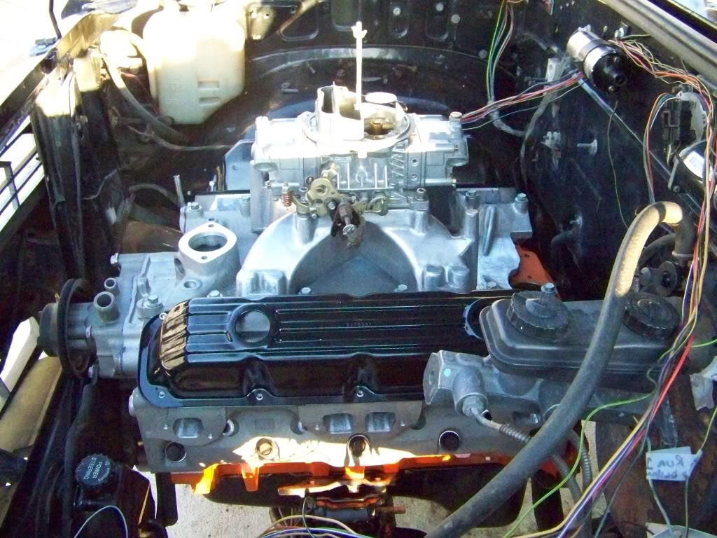

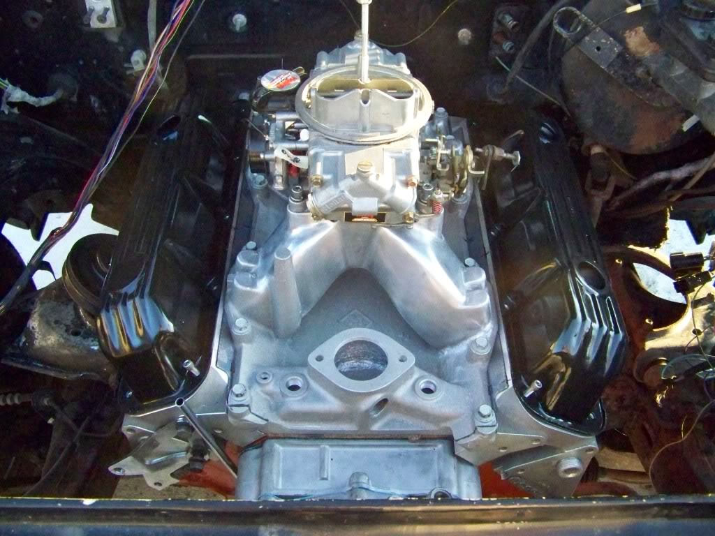

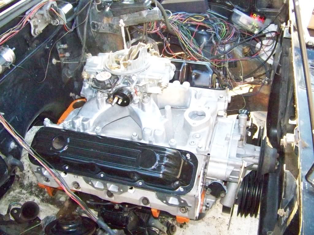

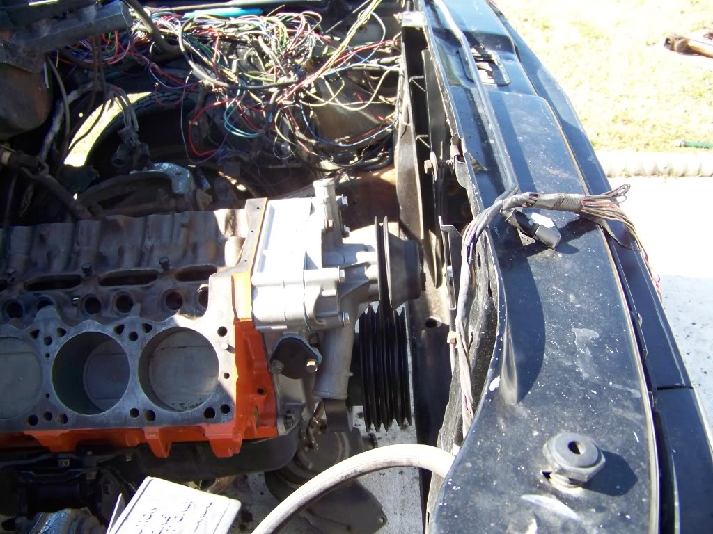

Well, I am done for today. Need to start on the linkages tomorrow. Maybe Friday, I will wire it up.
In case anyone is wondering why I have so many pics uploaded. It is mainly for those that are contemplating this swap on this era truck. Or, those that are wondering about carburetion (since I am from that era, and am probably more familiar with it than generation Y+). I apologize if it makes the thread slow to upload.

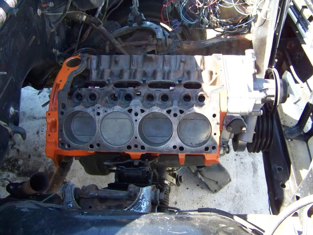

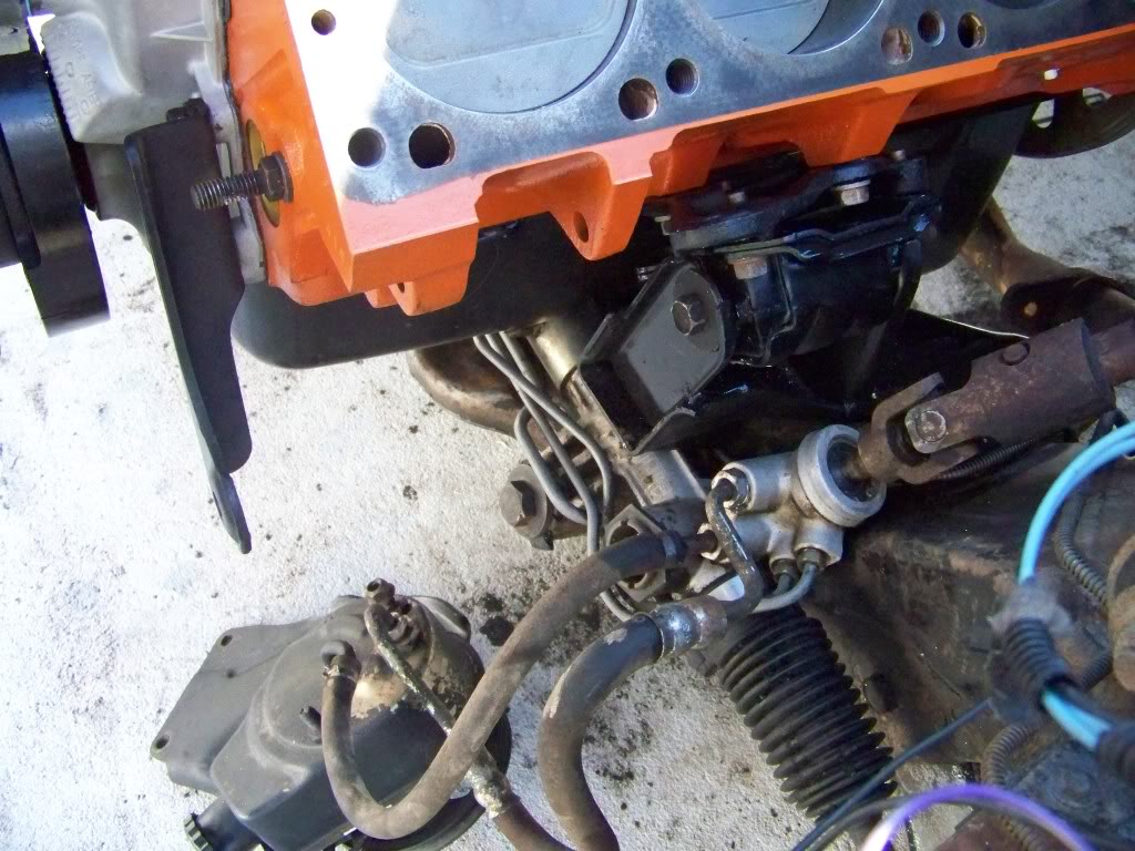

Old Dec 11, 2010 | 12:08 PM
  #30
siggie30's Avatar
siggie30
Joined: Oct 2010
Posts: 579
From: Florida
The radiator that was in it will not clear the water pump. Looking for options and pictures of successful swaps! It may not be the stock tranny as it looks much newer than the original accessories.
UPDATES: A518 tranny is in. Started running the ignition system and electronics. The stock speedo gear does not fit. Will have to go procure one from another Dak. Also the cooler lines between the A500 and A518, while close, are incompatible unless your careful rebending the lines (more of a twist as opposed to bending). The size of the orifices at the tranny differ as well, the A518 ones are larger. Will probably run new fuel lines from the tank and relocate the filter to the engine bay for better serviceability.
Pics to come as it looks appropriate.
