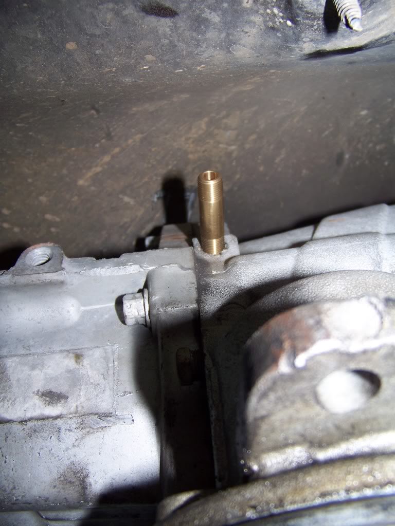

Transmission wiring: The two pressure fittings are 54 psi and 48 psi for the OD and the Lockup. I am an aggressive driver so I opted for the upper side of pressure. I will also have 28-29" tires, so I figured this in with my 3.55 gears. When I change my rear gears later, I may need to change the psi switch or switches to accomodate the change. I am told they are about $15 each. This is the kit from PATC which I paid just under $90.
These are the pressure switches and the tee tap for the transmission.
This is the full pressure port on the passenger side of the transmission.
Put a 1 1/2" straight fitting into the port (you could use a 1" section as well (I did not use sealant to maintain a ground).

Attach the tee fitting.

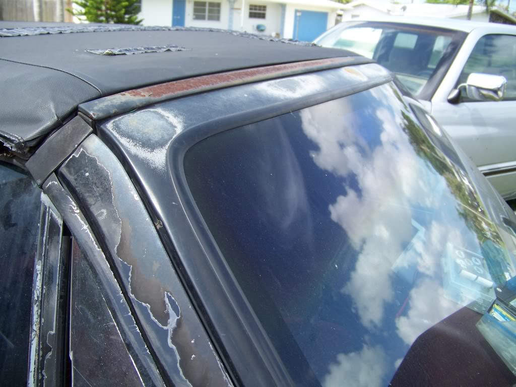

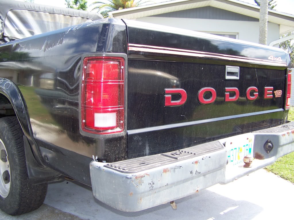

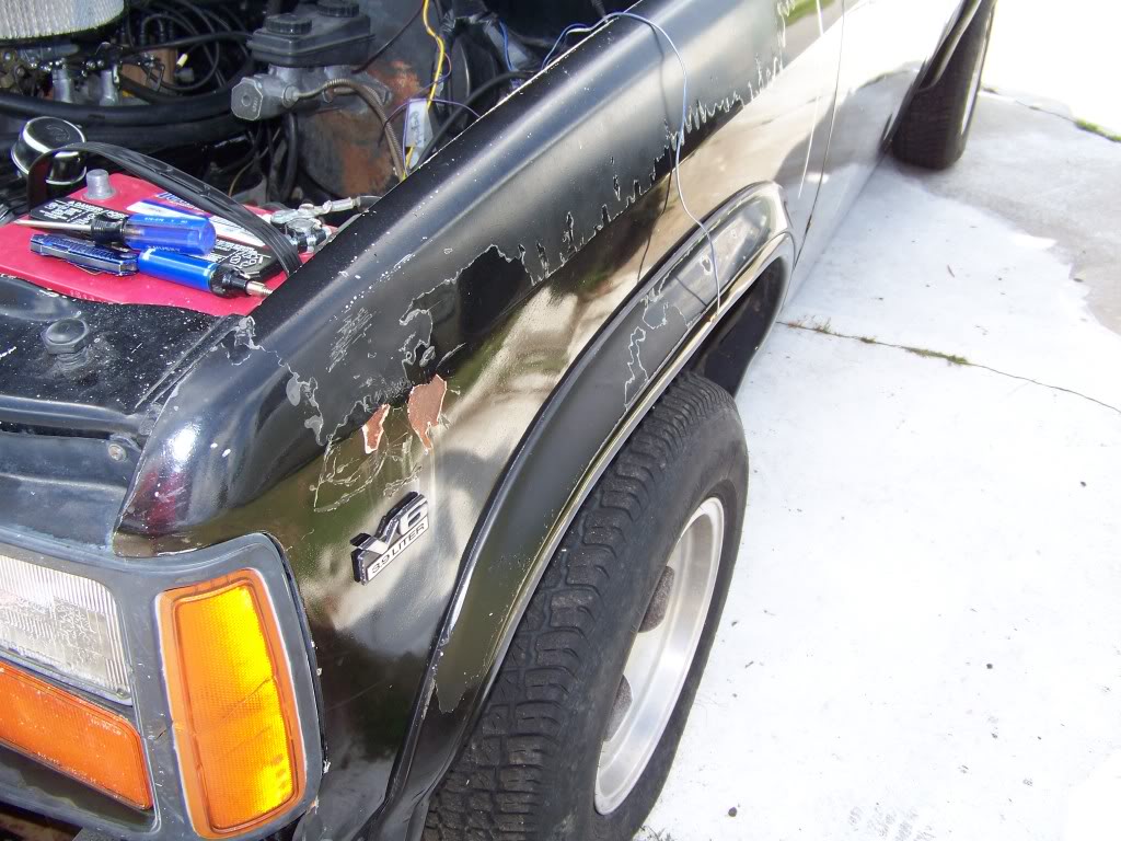

Pics of existing paint before body work:

I think that the previous owner had repainted the vehicle. The painter did not prep the surface (etching) so alot of paint is peeling. The more the better since I am taking it to 90% metal.
