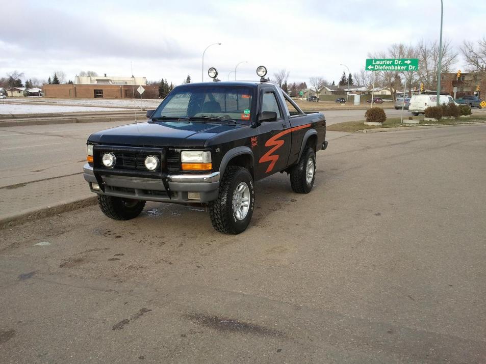

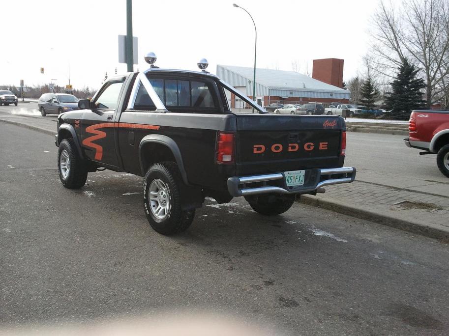

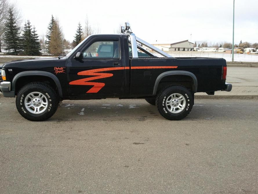

So i ended up welding tabs on one key and getting the front lifted to the point were there is just barely contact with the bump stops and in the back i ended up just doing cheater blocks for now. Although i got myself into a bind and am now stuck in a situation were i have to drive it.
All seemed well, just a little rubbing on the back of the tires when turning. But then i had to work the truck in the field (4wd soft and mucky ground with a bit of snow). At first i noticed a grinding clunking sound when turning, then while pulling a truck n trailer back to the road i noticed the same sounds while going forward. Now ive noticed it in 2wd while turning sharp after ive been driving the truck for a while.
My first thought was cv's are binding...but im curious. Is this because i had wore out cv joints before and the lift just showed the problem or is it a common problem when cranking torsion bars? Dont you have yours cranked right up? Do you get this sound? Will the truck be ok like this? I know and understand the whole shorted life thing and ill be happy if i get 10,000 to 15,000 miles out of them because after this winter i plan on buying something newer and the dakota will be tore apart and built as a toy just for the weekends.
But anyways, pictures of the progress! I think it looks higher in person. But those were just a couple quick cell phone pictures after washing the mud off.
It looks good.
It could be the CV's. Or just tires rubbing, you may need to cut the corners off of the fenders to keep it from slicing into your tire during articulation.
It is usual to feel binding and clunking or slipping while engaged in 4wd and turning.
