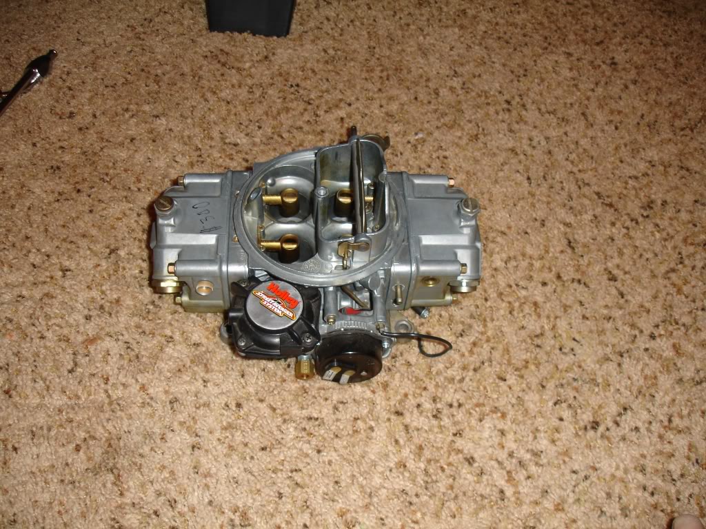

this is NOT the tb off the truck, but its either almost identical, or identical. the one on the dakota i looked at was gold colored where it says holley
That is a Throttle body, which is part of an EFI engine. This is a carburetor for reference.
Plus, why not just look at the ECU box?
