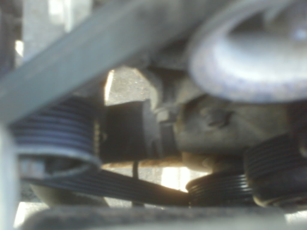

i've been checking the coolant level the last few days and the coolant level is the same as when i filled it up and it hasn't leaked since. my grandpa thinks that maybe it just had an air bubble in it. the gauge hasn't gone up past 1/4 on the scale.
i found some pics i took. i apologize in advance for the quality(i changed a setting a while back and now i can't get it back to normal)
the acc. and belt

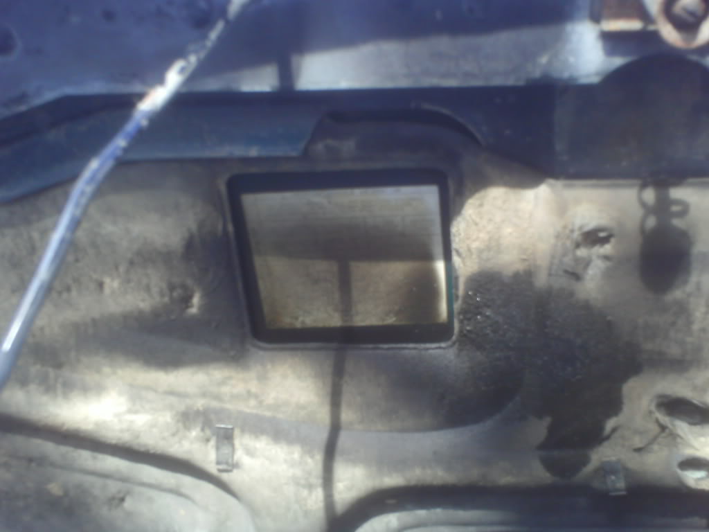

the hood. i cleaned that sticker a few weeks ago.

Just a word of warning. You said you were planning on getting rid of the a/c and i wanted to warn you that refridgerant can cause blindness so it would be a good idea to have a shop evacuate the system before you try to disconnect the a/c lines. You might have to change the serpentine belt, if you have one, unless you leave the compressor in place as the old belt won't fit without the compressor.

Sorry i just noticed the serpentine belt in your pictures.
