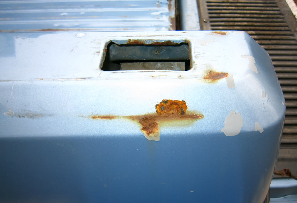

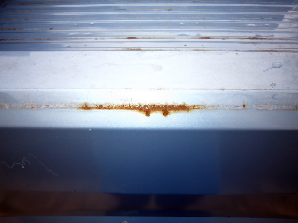

Yeah I'm thinking repair is a better route the damage is isolated; the rest is solid. A new bed would run at least $500
I don't want 4x4 anymore, just a small lift and an LSD (maybe even a locker) it's more of a street rod at this point (becoming). Plus this truck is very sentimental I'm going to make due

Yeah, the Dakota's have poorly designed beds when it comes to rain. Mine is water-tight, it's like a swimming pool! I got home with it one night when there was flooding from the rain, in some spots 7-8in of water, and I opened the tailgate and about 2-4in of water just rushed out from the whole bed. I'm pretty sure every 1st gen Dakota has the surface rust in between the bed and the tailgate where you have that surface rust.

Wire wheel with a drill will do wonders! take it down to bare metal them prime and paint. at least if its all surface rust.

Fair enough that it has sentimental value, I can feel ya since my truck does to being my first ride. Wire brush is your best bet, and I would through that rust protection with a paint brush, it might not win you any rewards for look, but if you go light 4x4 then the paint won't scratch. I would also advise not going with a locker, the LSD is more than enough for our trucks.

Over here in New England our roads are HEAVILY salted, yeah I will try a wire wheel first and see where it goes I'm not in any rush to replace I will monitor the rust through the summer and see if it comes back through.
Mine fills with water too I was going to drill some drain holes toward the front and back of the box.
