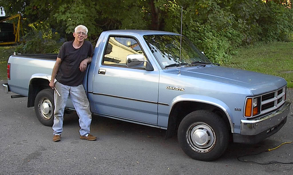

Here is my grandfather next to it just a few years ago:

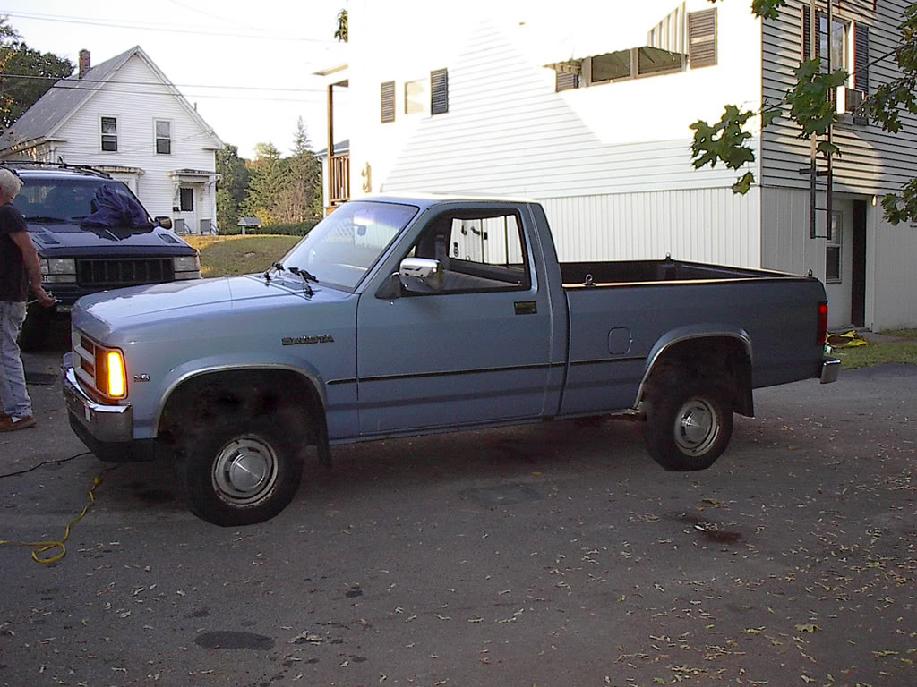

I did this in Photoshop, looks like about a 2-4" raise. Can I use BOTH an add a leaf AND a block lift on the rear end? Or would I run into problems not being able to use enough coil spacers on the front?
