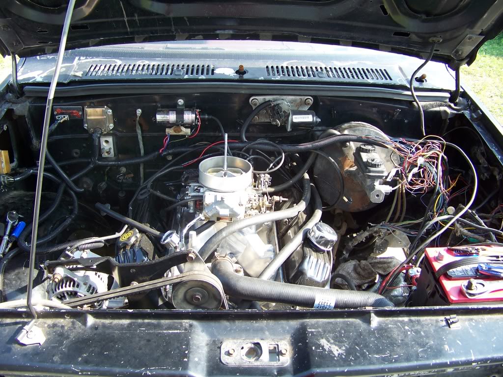

Here is my way of mounting an LA into a Gen1.....
The bracket is large, made to include the sway bar mounting, which is 2" shorter than the old sway bar bracket, hence the 2x2 spacers, temporarily thin metal tubing. They will be blocks of aluminum.
The blocks of wood represent the motor mount cushions. I will be drilling the frame later today and making it permanent.

Mine will be a very basic "town" truck, no power steering, no AC, just a balanced 330HP LA360 with Magnum heads and 92-93 exhaust manifolds, 3" single exhaust, 727 with floor mounted cable shifter and cable kickdown , 3.55 suregrip.....and a 125mph speedometer....
The dirty engine shown in the chassis now is a Magnum engine, using it for the mockup to make sure everything fits.
If I use the Magnum exhaust manifolds, it is a tight fit from Y pipe to passenger side frame, so I have moved the engine towards the drivers side about a half inch or so....
But I am thinking about headers....and dual exhausts. That means a new gas tank where the spare tire goes....
That's the plan....
