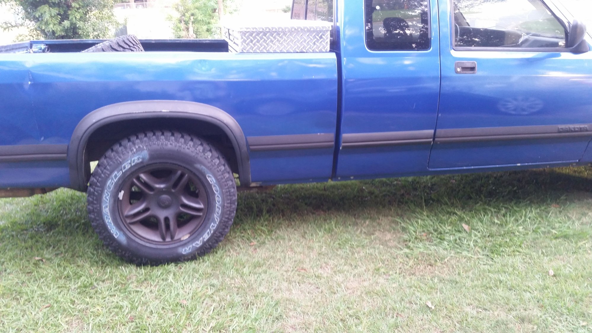

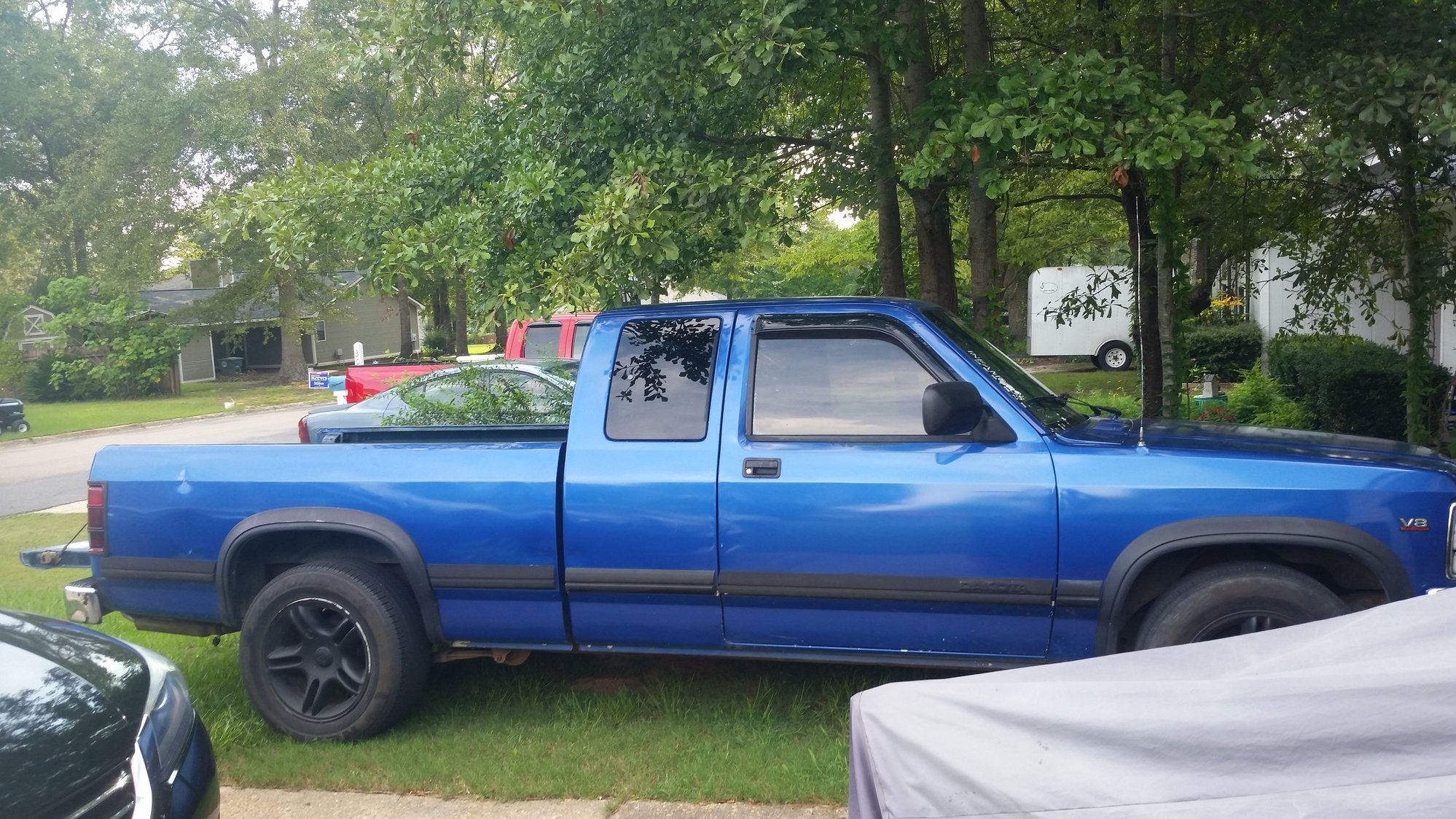

This is after i put 265 70 17 on it they clear in the back but in the front they are scrubbing. Was running out of time at tire shop being that it was late in day had him put the old ones back on front for now my ? Is i have 1 to 1 1/2 inch coil spacers and i order rancho front shocks with 0 -1 inch of lift will i be able to clear the 265 with this set up? Any info would be greatly appreciated. Haven't installed spacers yet was thinking running two on each side at 1 inch and also the spacer I have are for in the coil itself not for above or below will this still work? Sorry new to the lift world -alabama
