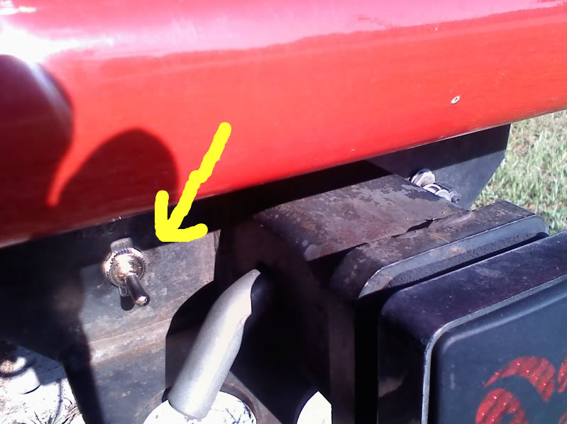

I made myself a little mount to slide into my hitch, have a dual wiring setup with a switch. Switch off and they are normal reverse lights, switch on and they stay on, so I can use them if I'm doing something behind the truck.

Nice, I'd rather have the switch inside the cab like maybe near the ashtray or something, or maybe make a cool box on the ceiling..

I do a lot of night fishing for big cats in south Georgia. We usually setup noodles or jugs and limb lines on the river from a jon boat and then fish from the sandbar with poles. I use the back of the truck and tailgate for gear and a bench for rigging/etc. So I found for my purposes it's more convenient to have my light switch at the tailgate.

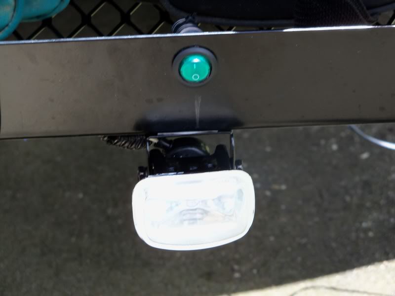

Now I also built a fishing rig for the front receiver hitch on my Grand Cherokee that is lighted. I have a switch on it as well, but also used a wireless relay and setup an unused HomeLink (garage door opener) button to operate the lights as well as have a key fob for it. It's sweet...

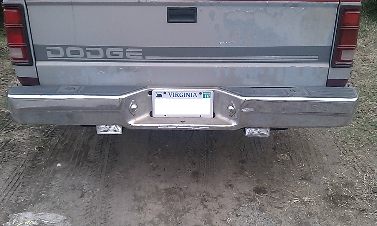

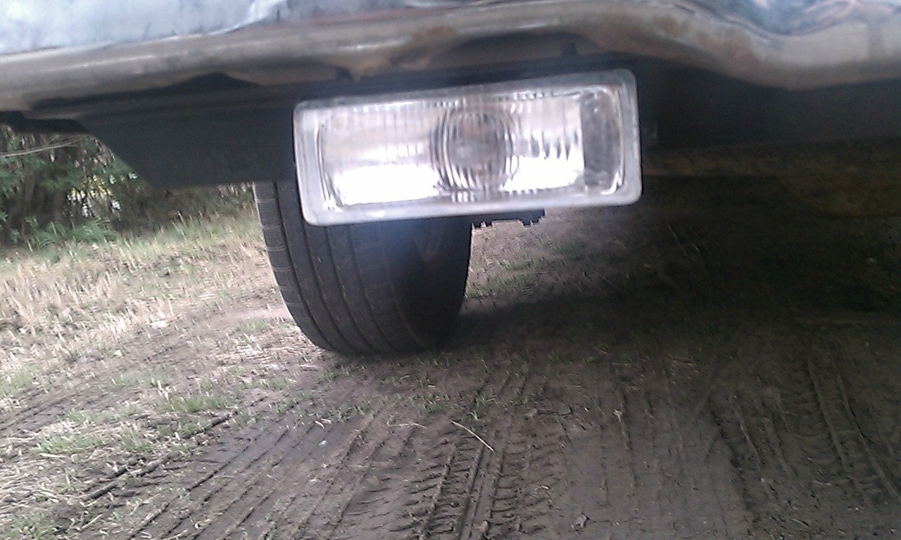

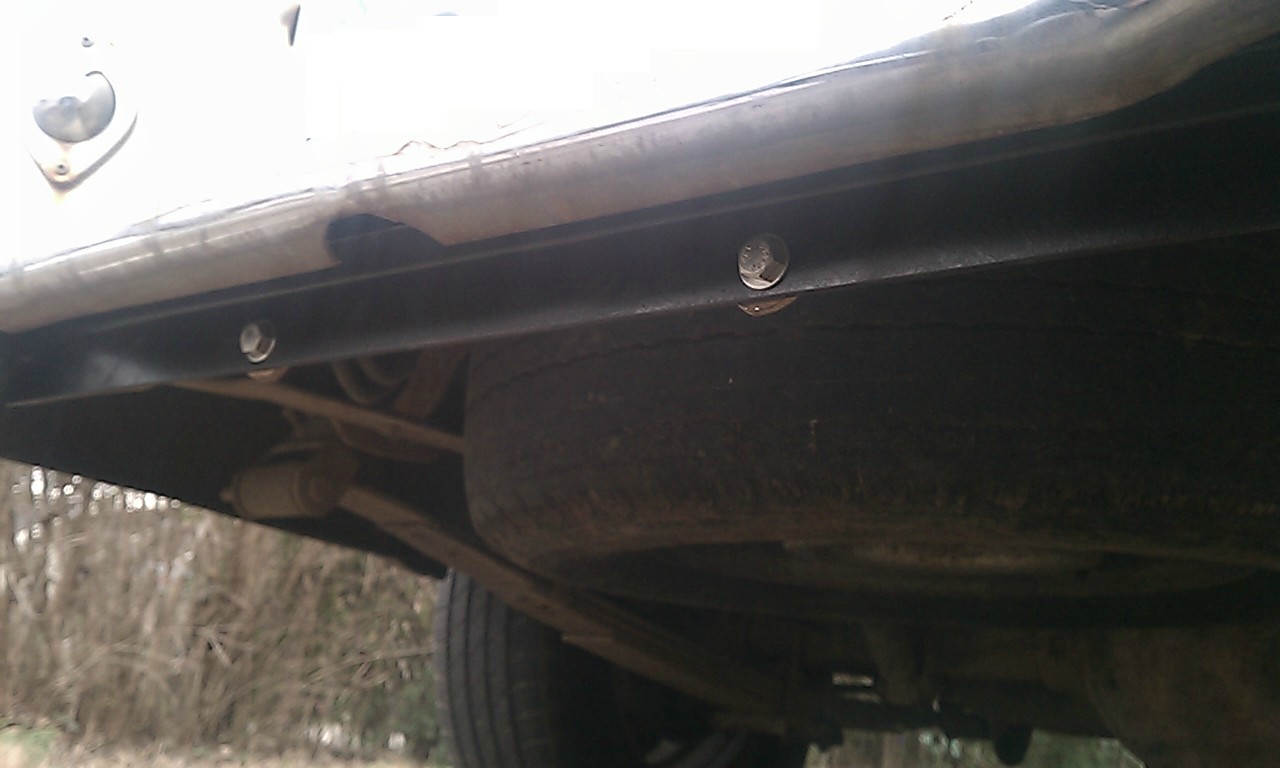

My New Lights/Bracket, they are straighter than it looks.. cell phone camera sucks and I was at an angle.
I mounted them to the towing chain holes.
