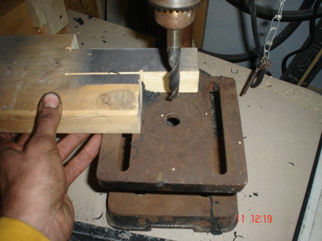

You'll have to drill out the pucks. Use a 7/16" bit for the bed bolts and 9/16" for the cab bolts. Make yourself a little jig for your drill press to make the holes perfectly center so your pucks stack nicely.
Jig:
