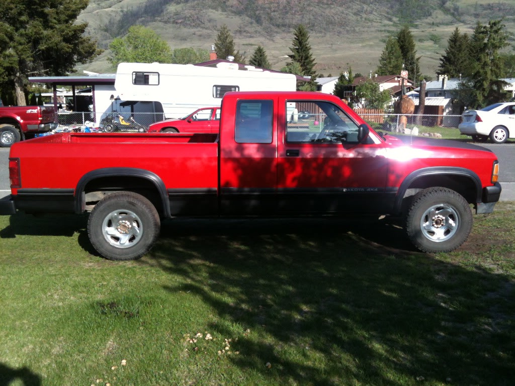

I wanna get some bigger tires on my truck eventually. But I'm torn between either 30s or 31s.
I know that if I want 31s I'll have to lift the front end but I'm not to concerned about that.
Could those of you with these sized tires on your trucks post some pictures so I can get an idea on how they effect the stance of the truck? I mostly just want those wheel wells filled a bit more. Those 235's I have now are doing a poor job of it. For reference heres a pic of my truck.

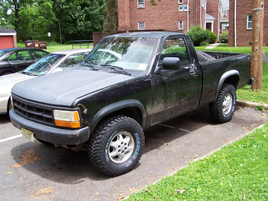

My new 31"s, stock height, stock suspension and everything. No rubbing.
I have since cranked the torsion bars a little bit to level it out some. The trick to that is NOT to do it too much, you don't want the axles to be much past a straight line, or you will wear out cv's.
