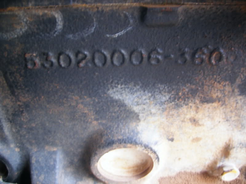

On my '98 5.9 block "360" was actually next to the casting number. At least what I think is the casting number.

Good info, thanks for the answers and also thanks for posting the picture.

Bought a 5.9 motor last night and started the job of cleaning it up today. Checked the casting number out and AZ360 it is the exact same number you posted back in June when we were asking how to tell the actual size of the motor.
