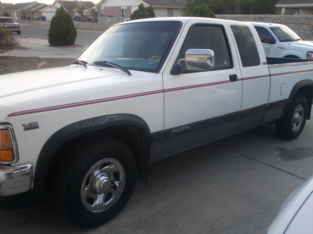

I recently bought a 94 Dakota Extended cab, 3.9 v6 from the original owner to give to my little bro when he turns 16. I was doing the full tune up and the bearings are bad on the tensioner pulley, The factory pulley is a little over 90mm everything I can find online is 76mm Auto zone and oreillys only carry the 76mm, If I use the belt for the truck (new one) it doesnt get tight with the smaller pulley, So...Should I buy another belt (shorter) and run the smaller pulley or does anyone know where I can find the right pulley for the truck. Its got power steering, Ac and how do i find out if the AC is factory or dealer installed? That was a question that kept coming up at auto part stores. Thanks! Heres some pics, Super super clean, Power windows mirrors Ice cold AC everything works the way it should. I took the camper shell off as soon as I got the truck home.
Putting new battery so didnt have to push off trailer
