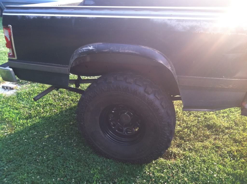

Here are some pics of the truck
And yes those are 37x12.50 super swamper tsl's
